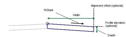

This subassembly creates a simple lane with finish grade and subbase, where the edge-of-traveled-way can be tied to an alignment or profile.
The attachment point is either (a) at the inside edge of lane on finished grade, if the insertion point is Crown, or (b) at the outside edge of travel way,if the insertion point is at the edge of travel way.

Width |
Width of lane |
Numeric, positive |
3.6 m 12.0 ft |
Depth |
Depth from finish grade to subbase |
Numeric, positive |
0.2 m 0.67 ft |
%Slope |
% Slope of the lane |

This subassembly provides a simple travel lane that can tie to an alignment for variable width, and a profile for variable slope. The behavior depends on the Transition type selected:
Transition Type |
Description |
Hold offset and elevation |
The width and slope of the lane is held to the Width and % Slope input parameter values. |
Hold elevation, change offset |
The elevation of the edge-of-traveled-way is calculated from the Width and % slope input parameter values. The width is then tied to the offset alignment. |
Hold grade, change offset |
The width is adjusted to tie to the offset alignment. The % Slope input value is held for the adjusted width. |
Hold offset, change elevation |
The width is held to the Width input parameter value. The elevation of the edge-of-traveled-way is tied to the offset profile. |
Change offset and elevation |
The width is tied to the offset alignment, and the slope is adjusted to tie the elevation of the edge-of-traveled-way to the offset profile. |
