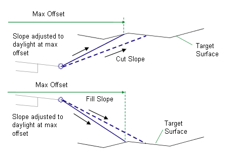

This subassembly inserts a link that extends to a target surface at a user-defined cut or fill slope.
If necessary, the slope is adjusted to keep the daylight point within a maximum +/- offset from the baseline.

Behavior
This subassembly attempts to calculate a daylight point for the cut condition. If a daylight point is found, its offset is compared to the Max Offset value. If the Max Offset value is exceeded, the daylight point is moved to the maximum offset point on the target surface. If no cut daylight point is found, the process is repeated for the fill condition.
If an offset horizontal alignment name is assigned to the Max Offset during corridor modeling, the value of the Max Offset will vary to match the offset of the alignment.

Layout Mode Operation
In layout mode, this subassembly displays both the cut and fill slopes in dashed lines extended outward for a distance of 3 meters or 10 feet. The daylight links are terminated with arrowheads pointing outwards.

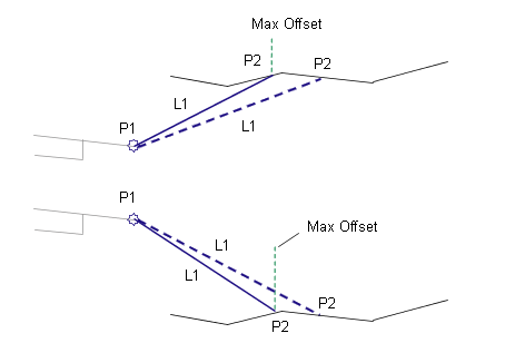

Point, Link, and Shape Codes
The following table lists the point, link, and shape codes for this subassembly that have codes assigned to them. Point, link, or shape codes for this subassembly that do not have codes assigned are not included in this table.
Point, Link, or Shape
Code
Description
P1
Hinge
Hinge_Cut or
Hinge_Fill
Hinge point, and hinge point for the cut or fill condition
P2
Daylight
Daylight_Cut or
Daylight_Fill
Daylight point, and daylight point for the cut or fill condition
L1
Top
Datum
L1
Top
Datum
Daylight
Daylight_Cut
Daylight link for cut section
L1
Top
Datum
Daylight
Daylight_Fill
Daylight link for fill section
