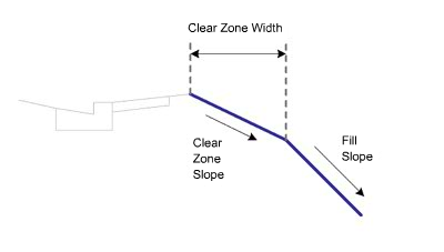

If it is in fill, and Berm is set to Omit, a link is added from the attachment point at the Clear Zone Slope until the Clear Zone Width is met. Then a daylight link is added to the target surface at the fill slope specified. If the clear zone link intersects existing ground, it will stop at this intersection point.
