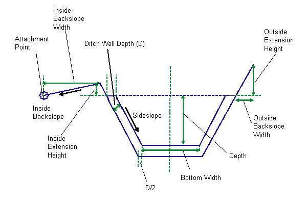

SideDitch
The subassembly is used to create a ditch structure with optional backslope and foreslopes.
The attachment point is the innermost point on the grading links preceding the ditch structure. If grading links are omitted, then the attachment point is the innermost point on the inside wall of the ditch structure (shown in blue circle).
Input Parameters
Note: All dimensions are in meters or feet unless otherwise noted. All slopes are in run-over-rise form (for example, 4 : 1), unless indicated as a percent slope with a “%” sign.
Parameter Description Type Default
Side
Specifes to insert the subassembly either on the right or the left side of the attachment point.
Left / Right Right
Depth Inside depth of the ditch. Numeric, Positive
0.45 m
1.5 ft
Bottom Width Width of bottom of the channel. Numeric, Positive
0.5 m
1.5 ft
Sideslope Ditch sideslopes Numeric 1:2
Ditch Wall Depth Depth of the ditch wall. This is measured perpendicular to the side of the slope, as shown in the previous diagram. Numeric, Positive
0.1 m
0.33 ft
Inside Extension Height Non-lined extension of ditch inside over the attachment point Numeric, Positive
0.15 m
0.45 ft
Inside Backslope Width Ditch backfill width on the inside Numeric, Positive
1.5 m
5.0 ft
Outside Backslope Width Width of non-lined width beyond the outer point of the ditch structure Numeric, Positive
0.1 m
0.33 ft
Target Parameters
This section lists the parameters in this subassembly that can be mapped to one or more target objects, such as a surface, alignment, or profile object in a drawing. For more information, see in the AutoCAD Civil 3D User’s Guide Help.
Target Parameters: None.
Output Parameters
None.
Behavior
The subassembly builds the shape for a ditch structure, as shown in the above illustration.
