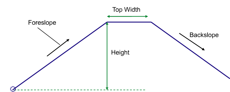

This subassembly inserts a noise barrier with the option to specify a topsoil material.
The attachment point is at the inside edge of the barrier, which is typically at the outside edge-of-traveled way or shoulder or another road element.

Top Width | Width of the top barrier top. | Numeric, Positive |
1.0m 3.0 ft |
Foreslope | Default slope of the barrier foreslope link. | Numeric | 1:1.5 |
Backslope | Default slope of the barrier back slope link. | Numeric | 1:1.5 |
Height | Specifies height of the barrier measure from the attachment point elevation. | Numeric, Positive |
3.00m 9.00ft |

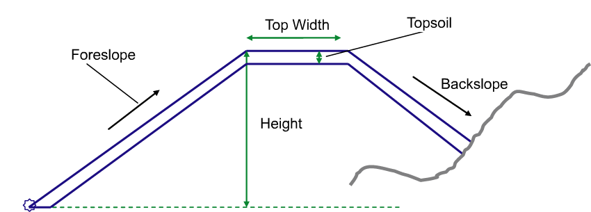

Topsoil Thickness | Specifies depth of material lining along daylight link. If a value of zero is entered, then no lining material is added. | Numeric, positive | 0.0 |
Topsoil Shape Code | Specifies shape code for the topsoil material | String | Topsoil |

Target Surface | Can be used to tie in the back of the barrier into an existing surface at the user defined slope. The following object types can be used as targets for specifying this surfaces: surfaces. | Optional |

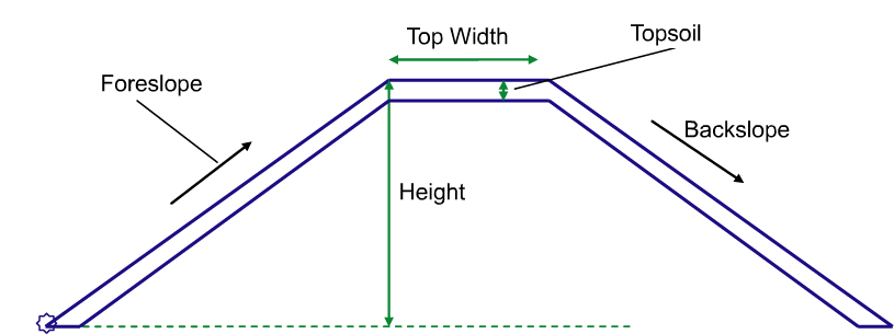

This noise barrier is introduced from the attachment point with the foreslope and backslope as specified by the user. If the Top width is set to zero value, then a triangular shaped noise barrier results. Further if a topsoil layer is selected for this subassembly – then a lined material layer is introduced as illustrated below. (Note: a horizontal link at the attachment point is introduced such that the thickness of the material is equal to the specified value).
If the backslope is tied into a surface, then that side height is adjusted to daylight into the surface as shown below.
If the backslope is not tied into any surface, then the height of that side is set with specified height. Further, if the surface at that point is higher than the top of the barrier then again backslope link is drawn downwards with specified slope and height parameters.
