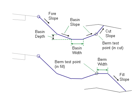

This subassembly inserts links to create a basin and cut daylight slope for a cut condition, or a basin, berm, and fill slope for a fill condition.
The final daylighting link can be omitted in cases where the corridor model needs to be left in an incomplete state. For example, this might be done so that grading surfaces on adjacent properties can tie to the hinge point on the uncompleted roadway.
You can also specify optional lined materials for daylight and other links (All Links, Daylight Links, Fill Links Only, and None).
The attachment point is at the inside edge of the basin foreslope. This component can be attached to either the left or right side.

Behavior
The subassembly builds the links for the basin foreslope and basin out to the basin test point. If a profile is given, the width of the foreslope varies to hold to the basin profile, while the basin depth is held constant. If the basin test point is in cut, the daylight intercept is calculated on the target surface at the given Cut Slope. If it is in fill, a top-of-berm link is added, and the daylight intercept is calculated on the target surface at the given Fill Slope. The daylight link is not inserted if Omit Daylight Link is set to True. If the top-of-berm link intersects the target surface, the section is terminated at the intersection.

Layout Mode Operation
In layout mode, this subassembly draws the foreslope, basin sideslopes, and basin bottom with the given input parameter values. Both the cut and fill condition links are shown in dashed lines, with the daylight links extended outward for a width of 3 meters or 10 feet at the given slopes. The daylight links terminate in arrowheads pointing outwards.
