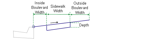

UrbanSidewalk
This subassembly inserts links for a concrete sidewalk with inside and outside grass boulevards.
The attachment point is at the inside edge of the inside boulevard. The UrbanSidewalk subassembly is typically attached to a back-of-curb or edge of pavement.

Behavior
The inside grass strip, sidewalk, and outside grass boulevard links are inserted outward from the attachment point at the given slope. The grass strips can be omitted by specifying a zero-width.
Optionally, various element widths can be attained by attaching to offset alignments. Also, the sidewalk cross slope can be derived by tying into an offset profile.

Point, Link, and Shape Codes
Point / Link
Code
Description
P2
Sidewalk_In
Inside edge of sidewalk on finish grade
P3
Sidewalk_Out
Outside edge of sidewalk on finish grade
L1
Top
Sod
Datum
L2
Top
Sidewalk
L3
Top
Sod
Datum
L4 – L6
Sidewalk
Datum
S1
Sidewalk
Sidewalk concrete area
Coding Diagram
