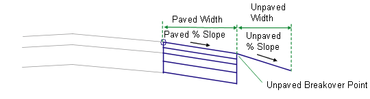

ShoulderVerticalSubbase
This subassembly inserts a paved shoulder with the pavement and subbase layers terminating with a vertical link.

Behavior
The links for the shoulder finish grade, Pave1, Pave2, Base and Subbase are inserted outward using the given Paved Width, Paved % Slope, material depths. If the Unpaved Link Treatment is 1, the unpaved shoulder link is inserted under all conditions. If the Treatment code is 2, the outside edge of the paved shoulder is checked to determine if it is in cut or fill; the unpaved shoulder link is inserted only in cut. Treatment code 3 uses the unpaved link in cut, or when the paved shoulder link has a positive %slope.The unpaved finish grade link is inserted at the given Unpaved % Slope, unless the difference between the Paved %Slope and Unpaved %Slope exceeds the Unpaved Max Breakover value. In that case the slope of the unpaved link is adjusted to hold the difference to the given breakover..
Layout Mode Operation
In layout mode, this subassembly displays the links comprising the shoulder for the normal crown roadway condition, based on the input parameters provided. If a numeric value is given for the Paved %Slope, the paved portion of the shoulder is calculated based on that value. Otherwise the default value of -6% is used.
