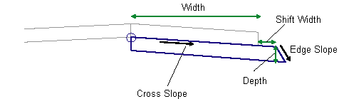

This subassembly creates a simple pavement structure with user-definable point, link, and shape codes.
This subassembly can be used as a lane or shoulder using superelevation parameters for the slope. The width and outside edge elevation can be calculated based on an optional alignment and profile. This subassembly can be stacked one below another to form multiple layers, or butted side by side to form multiple lanes with or without grade breaks. If multiple GenericPavementStructure subassemblies are stacked, the bottom slope can be used as the top slope of subsequent layers. Optionally, the bottom width of the subsequent subassembly can be assigned as the width of the previous subassembly.
The attachment point is at the upper inside edge of the pavement structure.
Note: All dimensions are in meters or feet unless otherwise noted. All slopes are in run-over-rise form (for example, 4 : 1), unless indicated as a percent slope with a “%” sign.

Width | Width of the subassembly. | Numeric, positive | 3.6 m 12.0 ft |
Shift Width | Specifies optional additional width to add. | Numeric, positive | 0.2 m 0.67 ft |

Depth | Depth from top link to the bottom link of the subassembly. | Numeric, positive | 0.2 m 0.67 ft |
Deflect Outer Vertical Face | Indicates to deflect outside vertical face to a specified slope. | Boolean Yes/No | No |
Outer Edge Slope | Specifies the slope of the outer edge if choose not to be vertical. | Numeric | 1:1 |

Top Width | Total width of the top link including the effective shift width. | Numeric, positive |
Bottom Width | Total bottom width of the pavement structure including the shift width and width due to the deflected outer face. | Numeric, positive |
Depth | Depth from top link to the bottom | Numeric, positive |
Cross Slope | Cross slope of the structure. | Numeric |
