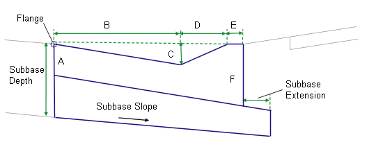

Dimension A |
Depth of the gutter at the flange point |
Numeric, positive, non-zero |
150 mm 6 in |
Dimension B |
Width from the gutter flange point to the gutter flowline |
610 mm 24 in |
Dimension C |
Depth from the gutter flange point to the gutter flowline, and from the gutter flowline to the top-of-curb |
100 mm 4 in |
Dimension D |
Width from the gutter flowline to the top-of-curb |
225 mm 9 in |
Dimension E |
Width from the top-of-curb to back-of-curb |
75 mm 3 in |
Dimension F |
Height of the back-of-curb |
300 mm 12 in |
The curb and gutter links are inserted based on the Input Parameter dimensions Dimension A – Dimension F. All dimensions must be positive, non-zero values. If a non-zero subbase depth is given, the subbase layer is inserted to the back of curb, and continues for the Subbase Extension width. The subbase layer closes to the bottom-back-of-curb, as shown in the diagram.
