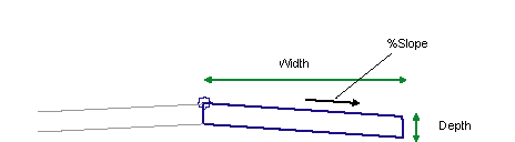

Behavior
The subassembly builds a finish grade and subbase surface, closed by vertical links at either end. The lane is inserted outward from the attachment point for the given width, depth, and slope.

Coding Diagram
