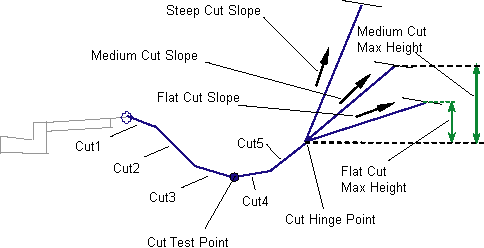

Flat Cut Slope
First, flattest, catch slope to attempt.
Numeric, positive
6 ( : 1)
Flat Cut Max Height
Maximum allowable height of the closing link using the Flat Cut Slope
Numeric, positive
1.5 m
5 ft
Medium Cut Slope
Cut slope to attempt if the Flat Cut Slope link exceeds the Flat Cut Max Height
Numeric, positive
4 ( : 1)
Medium Cut Max Height
Maximum allowable height of the closing link using the Medium Cut Slope.
Numeric, positive
3 m
10 ft
Steep Cut Slope
Cut slope to use if the Medium Cut Slope link exceeds the Medium Cut Max Height.
Numeric, positive
2 ( : 1)

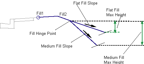

Flat Fill Slope
First, flattest, catch slope to attempt. (x : 1)
Numeric, positive
6 ( : 1)
Flat Fill Max Height
Maximum allowable height of the closing link using the Flat Fill Slope
Numeric, positive
1.5 m
5 ft
Medium Fill Slope
Fill slope to attempt if the Flat Fill Slope link exceeds the Flat Fill Max Height
Numeric, positive
4 ( : 1)
Medium Fill Max Height
Maximum allowable height of the closing link using the Medium Fill Slope
Numeric, positive
3 m
10 ft
Steep Fill Slope
Fill slope to use if the Medium Fill Slope link exceeds the Medium Fill Max Height
Numeric, positive
2 ( : 1)

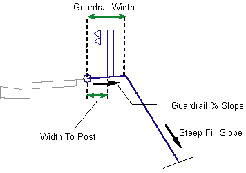

Guardrail Width
Width of the guardrail widening link for fill slopes using Steep Fill Slope. Use zero for no guardrail widening.
Numeric, positive
0.6 m
2 ft
Guardrail %Slope
% slope of the guardrail widening link
Numeric
-2 (%)
Include Guardrail
Omit Guardrail
Include to insert links for the guardrail structure on the guardrail widening segment. Omit does not insert the guardrail structure.
Include / Omit
Omit

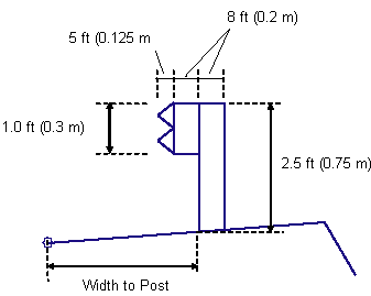

Width to Post
When the guardrail is included, the width from the attachment point to the inside edge of the guardrail post.
Numeric
0.3 m
1 ft

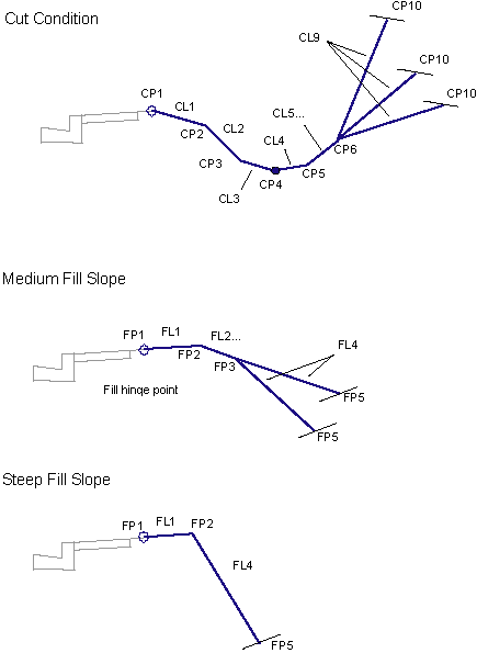

This subassembly is designed to accommodate a wide variety of clear zone, cut section, and fill section configurations. It allows up to eight links to be used in cut sections from the edge-of-roadway to the cut intercept hinge point, and any one of these links can be used as the cut test point. Up to three fill links can be used out to the fill hinge point, and provides special guardrail shoulder widening for steep fill conditions.
Cut links are denoted as Cut 1, Cut 2, up to Cut 8. The Cut Test Point input value indicates which cut link ends at the cut test point. The logical steps used are as follows:
  1. The cut surface links are constructed temporarily from Cut 1 to the cut link ending at the test point.
  2. If the test point, or any portion of the temporary surface, is below the target surface, the section is completed as a cut section. If the entire set of temporary links is above the target surface the section is completed as a fill section.
The cut example in the subassembly diagram show where five Cut links are defined. The cut test point is on the third link. The fill example shows two defined Fill links.

Cut Section
  1. If the cut test point is above the target surface, the links are traced backwards from the test point until an intersection with the target surface is found. The section is terminated at this point.
  2. If the test point is below the target surface, the remaining cut links are added one by one. Each one is tested to see if it intersects the daylight surface. If so, the cut section terminates at the intersection point and the appropriate Hinge and Daylight codes are assigned.
  3. To close to the target surface in cut:
    • If Include Daylight Link is set to False, no cut daylight intercept is calculated.
    • The intercept to the daylight surface is calculated using the Flat Cut Slope value.
    • If the height of the flat cut slope exceeds the Flat Cut Max Height, the intercept to the daylight surface is re-calculated using the Medium Cut Slope value.
    • If the height of the medium cut slope exceeds the Medium Cut Max Height, the intercept to the daylight surface is re-calculated using the Steep Cut Slope value.
Fill Section
  1. Fill links are inserted outward from the attachment point to the fill hinge point, which is the outer edge of the last non-zero fill link.
  2. When a fill link intersects the daylight surface before reaching the hinge point, the section is terminated at the intersection and the appropriate Hinge and Daylight point codes are assigned.
  3. To close to the target surface in fill:
    • The intercept to the target surface is calculated using the Flat Fill Slope value. If the height of the intercept link does not exceed the Flat Fill Max Height, this slope is used to add the link to the assembly, otherwise:
    • The intercept to the target surface is re-calculated using the Medium Fill Slope value. If the height of the intercept link does not exceed the Medium Fill Max Height, this slope is used to add the link to the assembly, otherwise:
    • If a non-zero guardrail width is given, the links (Fill 1, Fill 2 etc.) are removed. The guardrail widening link is added at the attachment point using the Guardrail Width and Guardrail %Slope parameters. The intercept to the target surface is re-calculated from the outside edge of the guardrail widening link using the Steep Fill Slope value, and the link is added to the assembly.
    • If the guardrail width is zero, the steep fill slope is applied from the fill hinge point.
A guardrail structure may be applied to fill sections that meet the criteria for using the steep fill slope. If this criteria is met, the Guardrail Width is not zero, and Include Guardrail is set to true, then a guardrail structure is drawn at the station. The dimensions of the guardrail structure are fixed as shown in the diagram below.

Point, Link, and Shape Codes
The following table lists the point, link, and shape codes for this subassembly that have codes assigned to them. Point, link, or shape codes for this subassembly that do not have codes assigned are not included in this table.
Point, Link, or Shape
Code
Description
CP(n+1)
Ditch_Out
Ditch test point at the end of Cut Link n, where n is the cut test point link number
CP (1 to n)
Hinge
Hinge_Cut
Hinge point for the cut intercept slope
CP10
Daylight
Daylight_Cut
Cut slope stake point
FP (1 to n)
Hinge
Hinge_Fill
Hinge point for the fill intercept slope
FP5
Daylight
Daylight_Fill
Fill slope stake point
All links
Top
Datum
All cut, fill, and guardrail links
Guardrail points
None
No codes are assigned to the points on the guardrail structure, if included.
Guardrail links
Guardrail
All links comprising the guardrail structure, if included.
Final daylight link
Top
Datum
Daylight
Daylight_Cut
Daylight link for cut section
Final daylight link
Top
Datum
Daylight
Daylight_Fill
Daylight link for fill section
Coding Diagram
