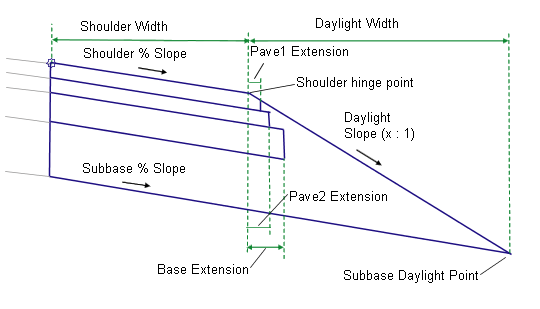

This subassembly inserts a paved shoulder with the subbase layer extended to a daylight point.
The attachment point is at the inside edge of the paved shoulder, which is typically at the outside edge-of-traveled way.

The finish grade of the shoulder is inserted for the given Shoulder Width and Shoulder % Slope outward from the attachment point, and the subbase link is inserted from the attachment point offset starting at the Subbase Depth below the finish grade.
The shoulder daylight link can be inserted with either a fixed slope (Hold Daylight Slope = True) or a fixed width (Hold Daylight Slope = False). If a fixed slope is used, the daylight link is extended from the outside edge of shoulder until it intersects the subbase link. Otherwise the subbase layer is extended for the Daylight Width beyond the outside edge of shoulder, and the daylight link is connected to the end of the subbase.
The Pave1, Pave2, and Base surface links are inserted parallel to the finish grade at the given depths. If the layer Extension values are non-zero, each layer is extended for the given distance beyond the shoulder hinge point. If a layer extends past the daylight slope, the layer is terminated at the daylight slope intersection. Each layer should be as wide or wider than the one above it.
In layout mode, this subassembly displays the links comprising the shoulder for a normal crown roadway situation. If numeric slope values are given for the Shoulder % Slope and Subbase % Slope, the links are shown at the given slope values. Otherwise the default slopes of -6% are used.

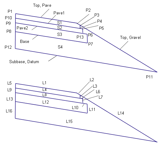

The following table lists the point, link, and shape codes for this subassembly that have codes assigned to them. Point, link, or shape codes for this subassembly that do not have codes assigned are not included in this table.
Type |
Code |
Description |
P2 |
EPS |
Edge of paved shoulder, finish grade |
P4 |
EPS Pave1 |
Edge of paved shoulder on Pave1 |
P13 |
EPS Pave2 |
Edge of paved shoulder on Pave2 |
P7 |
EPS Base |
Edge of paved shoulder on Base |
P11 |
Daylight Sub |
Subbase daylight point |
L1, L2 |
Top, Pave |
Paved finish grade |
L4 |
Pave1 |
L8 |
Pave2 |
L12 |
Base |
L15 |
Subbase Datum |
L14 |
Top, Gravel |
Unpaved finish grade |
Other Links |
As shown below |
S1 |
Pave1 |
S2 |
Pave2 |
S3 |
Base |
S4 |
Subbase |
