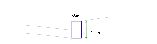

The subassembly builds a rectangular shape for a simple curb, with the attachment point at the bottom inside edge of curb.
Layout Mode Operation
In layout mode, this subassembly draws the curb shape as specified by the input parameters.

P1
BottomCurb
Inside bottom of curb
P2
TopCurb
Inside top of curb
P3
BackCurb
Outside top of curb
All links
Curb
S1
Curb
