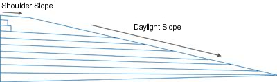

This subassembly inserts a shoulder that you can use to control superelevation. It also supports Pave 2 and Pave 3 Layer extension, as well as varying grade on Datum.
The attachment point is at the inside edge of the paved shoulder, which is typically at the outside edge-of-traveled way.
Note: All dimensions are in meters or feet unless otherwise noted. All slopes are in run-over-rise form (for example, 4 : 1) unless indicated as a percent slope with a “%” sign.

This section lists the parameters in this subassembly that can be mapped to one or more target objects, such as a surface, alignment, or profile object in a drawing. For more information, see in the AutoCAD Civil 3D User’s Guide Help.
Parameter | Type | Status |
Shoulder Width | May be used to override the fixed Shoulder Width and tie the edge-of-shoulder to an offset alignment. The following object types can be used as targets for specifying this: alignments, polylines, feature lines, or survey figures. | Optional |
Parameter | Description | Type |
Daylight Slope | Slope of the daylight link | Numeric |
Daylight Offset | Offset of the subgrade daylight point | Numeric |
Daylight Elevation | Elevation of the subgrade daylight point | Numeric |
Shoulder Width |
Width of the paved shoulder |
Numeric |
Shoulder Slope |
Slope of the paved shoulder |
Numeric |
This subassembly is inserted on the side of the attachment point specified. All links follow the slope specified for the top link L1, with the exception of L10. Link L10 is determined by the Subbase 3 Inner Depth and Super Elevation/Grade on Link L1, if a User specified Grade is not given for L10.
In layout mode, this subassembly displays the links comprising the shoulder for a normal crowned roadway situation. If numeric slope values are given for the Shoulder % Slope and Subbase % Slope, the links are shown at the given slope values. Otherwise the default slopes of -2.50% are used.
