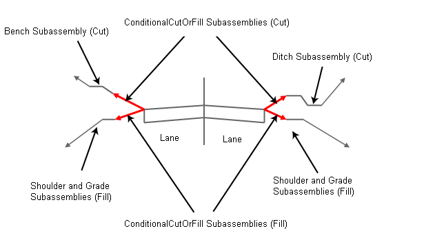

The following illustration shows a corridor assembly section comprised of:
You can add one or multiple ConditionalHorizontalTarget subassemblies to an assembly to create simple or complex conditional behaviors. For example, in the case of the previous example, you can add a set of polylines to the model that show the location of sidewalks. Because the lines stop where driveways cross the sidewalk, the conditional subassembly adds and removes the sidewalk depending on the presence of the sidewalk line. The conditional subassembly eliminates the need to apply a different assembly to the corridor where a sidewalk is not needed.
When you create an assembly using ConditionalHorizontalTarget subassemblies, the assembly construction displayed in the Construction tab of the Assembly Properties dialog box indicates the order in which the subassemblies are processed.
