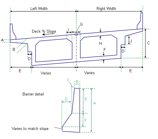

BridgeBoxGirder2
This subassembly creates a two-chamber box girder bridge shape with optional half-barriers.
This subassembly is designed to be used for visualization, not for structural design.
The attachment point is at the dividing line between the left and right lanes, on the bridge deck finish grade. The bridge section is built to the left and right sides.
Input Parameters
Note: All dimensions are in meters or feet unless otherwise noted. All slopes are in run-over-rise form (for example, 4 : 1) unless indicated as a percent slope with a “%” sign.
Parameter
Description
Type
Default
Left Lane Width
Width of the left lanes of the bridge deck
Numeric, positive
5.34 m
17.8 ft
Right Lane Width
Width of the right lanes of the bridge deck
Numeric, positive
5.34 m
17.8 ft
Deck Slope - Use Superelevation
Specifies to use the superelevation slope for the bridge deck slope.
List of options: No, Left Outside Lane Slope, Left Inside Lane Slope
Default Deck Slope
Specifies default slope for the bridge deck
Numeric, positive
2.0%
Include Barriers
Omit Barriers
Includes or omits barriers to each side of the bridge deck.
Include / Omit
Include
Dimension A
Deck thickness at the edge
Numeric, positive
0.200 m
0.667 ft
Dimension B
Deck thickness at the flange
Numeric, positive
0.300 m
1.0 ft
Dimension C
Total depth from finish grade to bottom of soffit
Numeric, positive
1.8 m
6.0 ft
Dimension D
Step width
Numeric, positive
0.150 m
0.5 ft
Dimension E
Total flange width
Numeric, positive
1.425 m
4.75 ft
Dimension F
Bottom girder thickness
Numeric, positive
0.170 m
0.5625 ft
Dimension G
Center girder thickness
Numeric, positive
0.250 m
0.833 ft
Dimension H
Top girder thickness
Numeric, positive
0.210 m
0.7 ft
Dimension I
Width of the top corner of the inside girder
Numeric, positive
0.300 m
1.0 ft
Dimension J
Step height
Numeric, positive
0.600 m
2.0 ft
Barrier A (mm or inches)
Height of the barrier at the center of median
Numeric, positive
810 mm
32 in
Barrier B (mm or inches)
As shown in diagram
Numeric, positive
131 mm
4.5 in
Barrier C (mm or inches)
As shown in diagram
Numeric, positive
59 mm
2 in
Barrier D (mm or inches)
As shown in diagram
Numeric, positive
125 mm
5 in
Barrier E (mm or inches)
As shown in diagram
Numeric, positive
557 mm
22 in
Barrier F (mm or inches)
As shown in diagram
Numeric, positive
178 mm
7 in

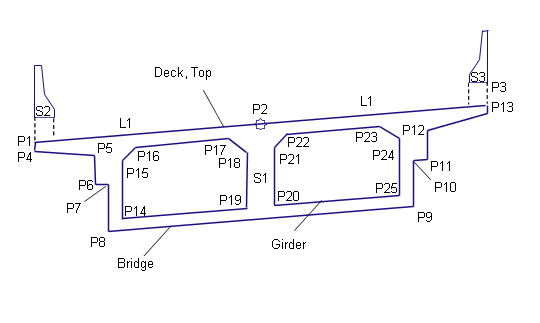

Point, Link, and Shape Codes
The following table lists the point, link, and shape codes for this subassembly that have codes assigned to them. Point, link, or shape codes for this subassembly that do not have codes assigned are not included in this table.
Point, Link, or Shape
Code
Description
P1, P3
EBD
Edge of bridge deck
P2
Crown_Deck
Crown point on bridge deck
L1
Deck, Top
Bridge
All exterior bridge substructure links
Girder
All interior bridge substructure links
All barrier links
Barrier
S1
Bridge
S2, S3
Barrier
Coding Diagram
