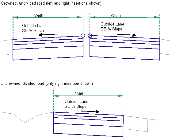

This subassembly creates a cross-sectional representation of a travel lane, applying the Outside or Inside Lane superelevation slope value for the corridor model’s baseline alignment.
It is used for most undivided roads, or divided roads with no lane slope break on either side. It may also be used for the outside or inside lanes of divided crowned or broken-back highways. The pavement structure follows the standards described in “Pavement Structure on Paved Sections” in the AutoCAD Civil 3D Help.
The attachment point is at the inside edge of the lane on the finish grade surface. This component can be attached to either the left or right side.
Note: All dimensions are in meters or feet unless otherwise noted. All slopes are in run-over-rise form (for example, 4 : 1) unless indicated as a percent slope with a “%” sign.

The lane superelevation slope is obtained from the superelevation specifications for the baseline alignment. You can specify which superelevation slope is used for the lane.
Starting at the attachment point, a finish grade surface and parallel subgrade are inserted using the given width, depth, and the superelevation slope. Vertical links close the shape at either end of the lane.
If an offset horizontal alignment name is assigned to the Width during corridor modeling, the width of the lane will vary to match the offset of the alignment. This subassembly can be used in assemblies that accomodate axis of rotation pivot points in different crowned and planar roadway types. For more information, see Building an Assembly that Supports Superelevation Axis of Rotation Pivot Points.
In layout mode, this subassembly displays all lane links using the width and depth input parameters at a -2% slope.
When Potential Pivot is set to Yes,
markers indicate the potential pivot points on the inside and outside points.
