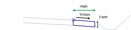

This subassembly creates a simple paved shoulder with finish grade and subbase.
The attachment point is at the inside edge of the shoulder on the finish grade.
Note: All dimensions are in meters or feet unless otherwise noted. All slopes are in run-over-rise form (for example, 4 : 1) unless indicated as a percent slope with a “%” sign.
Parameter |
Description |
Type |
Default |
Side |
Specifies which side to place the subassembly |
Left / Right |
Right |
Width |
Width of shoulder |
Numeric, positive |
0.9 m 3 ft |
Depth |
Depth from finish grade to subbase |
Numeric, positive |
0.2 m 0.67 ft |
%Slope |
% Slope of the shoulder |
Numeric |
-4% |
This section lists the parameters in this subassembly that can be mapped to one or more target objects. For more information, see in the AutoCAD Civil 3D User’s Guide Help.
Target Parameters: None.
None.
The shoulder links are inserted outwards from the attachment point at the given width, slope, and depth.
In layout mode, this subassembly draws the lane using the input parameters.
