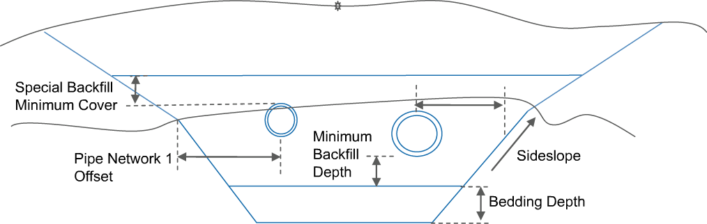

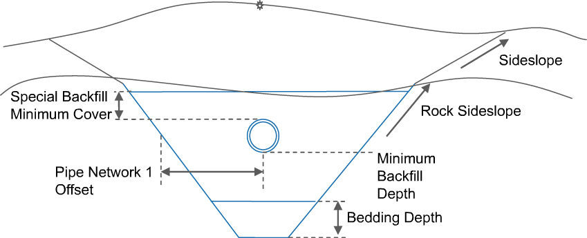

In both cases the subassembly will determine the bottom of trench depth and trench width based on the location of a pipe or pipes in specified networks. The Special Backfill Minimum Cover is determined by from the top outer diameter of the highest pipe found at the sampled section. The Special Backfill Minimum Depth is determined by the lower outer diameter of the lowest pipe found at the sampled station. Whichever surface the sideslope is below, the appropriate slope is used (rock or regular).
Case 1: Single Pipe Network Selected
If only Pipe Network 1 is selected, the subassembly will search 3 feet (1 meter) from the controlling baseline to the left and right to find the pipe centerline at the sampled station. Apply the Pipe Network 1 offset value to both sides to determine the pipe width, or the minimum width, whichever is smaller. The offset value is applied from the outer wall of the pipe as shown in the illustration. The bottom of the trench is determined by the pipe bottom outer diameter, plus the Special Backfill Minimum Depth, plus the Bedding Depth.
Case2: Two Pipe Networks Selected
When two pipe networks are selected, Pipe Network 1 will be assumed to be on the left side of the baseline, Pipe Network 2 will be assumed to be on the right side of the alignment. The material depth of the Special Backfill Minimum Depth will be determined by the higher of the two pipe top outer diameters, plus the Special Backfill Minimum Cover value. The bottom of the trench depth will be determined by the lower of the two pipe bottom outer diameters, plus the Special Backfill Minimum Depth, plus the Bedding Depth.
In layout mode, this subassembly draws a trench as shown in the previous illustrations.
