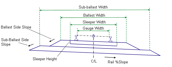

RailSingle
This subassembly inserts the rails, sleeper, ballast, and sub-ballast for a single-track railroad.
It should be followed with a Daylight subassembly on the left and right sides to close to existing ground in cut and fill situations.

The attachment point is at a distance equal to the rail height above the centerline of the sleeper.
Input Parameters
Note: All dimensions are in meters or feet unless otherwise noted. All slopes are in run-over-rise form (for example, 4 : 1) unless indicated as a percent slope with a “%” sign.
Parameter
Description
Type
Default
Rail % Slope
% slope of the roadbed
Numeric
0 (%)
Gauge Width
Width of the rail gauge from inside-to-inside rail. The rails are placed symetrically about the centerline alignment.
Numeric, positive
1.435 m
4.7083 ft (4’ 8-1/2”)
Sleeper Width
Width of the sleeper, placed symetrically about the centerline
Numeric, positive
2.4 m
8.0 ft
Sleeper Height
Height of the sleeper
Numeric, positive
0.200 m
0.67 ft
Ballast Width
Width of the top of the ballast layer, placed symetrically about the centerline
Numeric, positive
3.6 m
12.0 ft
Ballast Depth
Thickness of the ballast layer from finish grade
Numeric, positive
0.3
1.0 ft
Ballast Side Slope
Side slope (x : 1) of the ballast layer
Numeric, positive
2 (: 1)
Sub-ballast Width
Width of the top of the sub-ballast layer, placed symetrically about the centerline
Numeric, positive
6.6 m
22.0 ft
Sub-ballast Depth
Thickness of the sub-ballast layer
Numeric, positive
0.3
1.0 ft
Sub-ballast Side Slope
Side slope of the sub-ballast layer
Numeric, positive
2 (: 1)

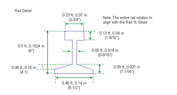

All rail points
R1, R2, ..…
Numbered sequentially for longitudinal connection (not shown in diagram)

Rail shapes
Rail
Not shown in diagram
