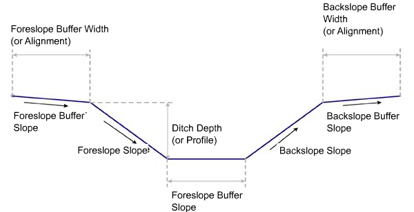

Behavior
This subassembly will insert a simple ditch shape (either flat bottom or V-shaped ditch) with optional foreslope and backslope buffers. The location of the inner ditch edge can be specified with a fixed width, or with an optional alignment. The ditch depth can be specified with a fixed height, or a profile can be assigned to control the depth. The Cut/Fill Test point is P3. Depending on the Include Ditch input parameter, the ditch will only be placed in cut, fill, or both cut and fill.

Layout Mode Operation
In layout mode, this subassembly displays all of the links comprising the ditch with the parameters set as input by the user.
Point, Link, and Shape Codes
The following table lists the point, link, and shape codes for this subassembly that have codes assigned to them. Point, link, or shape codes for this subassembly that do not have codes assigned are not included in this table.
Point, Link, or Shape Codes Description
P2 Hinge
P3 Ditch_In Inside bottom of ditch
P4 Ditch_Out Outside bottom of ditch
P5 Hinge
L1-5 Top Datum
L2,L4 Slope_Link
L3 Ditch Ditch Bottom
Coding Diagram
