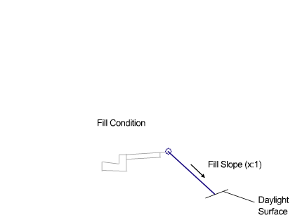

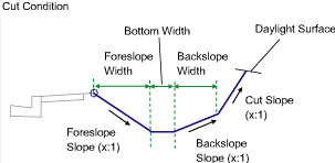

The attachment point is tested to determine if it is in cut or fill. If it is in fill, the fill daylight link is extended to the Existing Surface at the given Fill Slope.
If Point P1 or P2 are below the rock surface then the foreslope, ditch bottom, and backslope are added, the rock cut1 link is added at the height specified by Rock Cut1 Depth Limit. A second rock cut link is added until it reaches the rock surface at the Rock Cut 2 Slope. A stripped area is created as links are created that follow the rock surface for the specified buffer distance. Finally a daylight link to existing ground is inserted using the slope specified by the Daylight link Slope parameter.
If the daylight is not below the rock surface, the foreslope, ditch bottom, and backslope are added, and the cut daylight link is extended from the end of the backslope to the Daylight Surface at the given Cut Slope.

The following coding diagram shows the codes in a cut situation, without a rock surface.
The following coding diagram shows the codes in a fill situation.
