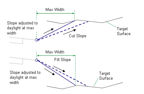

This subassembly inserts a link that daylights to a target surface at a user-defined cut or fill slope.
If necessary, the slope is adjusted to keep the daylight point within a maximum width from the hinge point.

Behavior
This subassembly attempts to calculate a daylight point for the cut condition. If a daylight point is found, the width of the daylight link is compared to the Max Width value. If the Max Width value is exceeded, the daylight point is moved to the maximum width point on the target surface. If no cut daylight point is found, the process is repeated for the fill condition.
If an offset horizontal alignment name is assigned to the Max Width during corridor modeling, the value of the Max Width will vary to match the offset of the alignment.
Like other daylight subassemblies, this subassembly optionally lets you add a lined material. You can specify three ranges of slopes. Material type 1 is applied if the slope of the links is up to the specified slope value. From slope 1 to slope 2, the second type of material applied. Similarly, if the slopes of links fall within slope 2 and slope 3 values, then material 3 is applied. If the link slopes are flatter than slope limit 3, then no material is applied.
If a lined material is added to the subassembly, then parallel links are added to the daylight links with specified thickness. This thickness parameter (for example, Material 1 Thickness) is measured perpendicular to the link. Bottom level links are coded with Datum and daylight links are coded with Top. Shapes enclosed by these materials are coded with material name.
