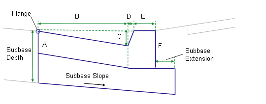

UrbanCurbGutterValley3
This subassembly inserts links for a slope-bottomed valley curb and gutter with subbase.
The bottom surface of the curve flattens to a horizontal link at the gutter flowline. User-defined input parameters control the dimensions of the shape.
The attachment point is at the flange point of the gutter or the back of the curb.
Input Parameters

Dimension A
Depth of the gutter at the flange point
Numeric, positive,
non-zero
150 mm
6 in
Dimension B
Width from the gutter flange point to the gutter flowline
Numeric, positive,
non-zero
600 mm
24 in
Dimension C
Depth from the gutter flange point to the gutter flowline, and from the gutter flowline to the top-of-curb
Numeric, positive,
non-zero
50 mm
2 in
Dimension D
Width from the gutter flowline to the top-of-curb
Numeric, positive,
non-zero
40 mm
1.5 in
Dimension E
Width from the top-of-curb to back-of-curb
Numeric, positive,
non-zero
150 mm
6 in
Dimension F
Height of the back-of-curb
Numeric, positive,
non-zero
300 mm
12 in
Behavior
The curb and gutter links are inserted based on the Input Parameter values for Dimension A – Dimension F. All dimensions must be positive, non-zero values. If a non-zero subbase depth is given, the subbase layer is inserted to the back of curb, and continues for the Subbase Extension width. The subbase layer closes to the bottom-back-of-curb, as shown in the diagram.
