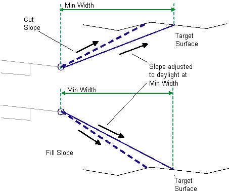

DaylightMinWidth
This subassembly inserts a link that daylights to a target surface at a user-defined cut or fill slope.
If necessary, the slope is adjusted to keep the daylight point beyond a minimum width from the hinge point.

Behavior
This subassembly attempts to calculate a daylight point for the cut condition. If a daylight point is found, the width of the daylight link is compared to the Min Width value. If the daylight point is within the Min Width, the daylight point is moved to the minimum width point on the target surface. If no cut daylight point is found, the process is repeated for the fill condition.
If an offset horizontal alignment name is assigned to the Min Width during corridor modeling, the value of the Min Width will vary to match the offset of the alignment.
Like other daylight subassemblies, this subassembly optionally lets you add a lined material. You can specify three ranges of slopes. Material type 1 is applied if the slope of the links is up to the specified slope value. From slope 1 to slope 2, the second type of material applied. Similarly, if the slopes of links fall within slope 2 and slope 3 values, then material 3 is applied. If the link slopes are flatter than slope limit 3, then no material is applied.

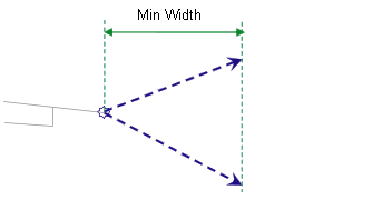

Layout Mode Operation
In layout mode, this subassembly displays both the cut and fill slopes in dashed lines extended outward for the Min Width distance. The daylight links are terminated with arrowheads pointing outwards.
