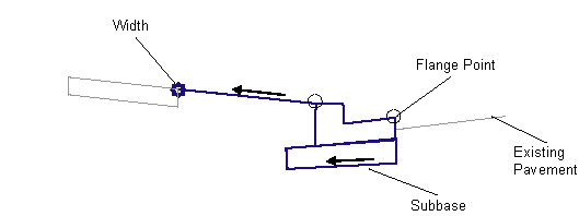

This subassembly is used to replace an existing curb and gutter, with the sod strip tying to the existing inside edge of sidewalk. The vertical placement of curb and gutter is determined by allowable milling and/or overlay at the flange points and by allowable ranges of slopes for sod strip.
To apply this subassembly, flange point information (alignment or offset value) is essential.
The attachment point is outside/highside point of the sod strip edge of the sidewalk. Though notionally this attachment point is to mark the highside of the sodstrip, actual location of sod strip high point could vary from this as the user attaches an appropriate marked point or alignment and profile. Therefore, this attachment point is more of layout time assistance rather than design point control.

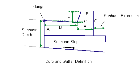

Subbase Depth |
Depth to subbase at the flange point. Use zero if there is no subbase. |
Numeric, positive |
0.450 m 1.5 ft |
Subbase Extension |
Distance the subbase is extended beyond the back-of-curb. Use zero to terminate the subbase at the back-of-curb. |
Numeric, positive |
0.3 m 1 ft |
Subbase Slope Method |
Selects whether to use the Outside Lane superelevation slope for the subbase layer, or to set a numeric % slope value |
Selection list |
Fixed Slope |
Subbase %Slope |
% slope of the subbase layer. Not used if Use SE is set to True. |
Numeric |
-2 (%) |
| Dimension A (mm/in) |
Depth of the gutter at the flange point. |
Numeric, positive, non-zero |
175 mm 6 in |
| Dimension B (mm/in) |
Width from the flange point to the gutter flowline. |
400 mm 16 in |
| Dimension C (mm/in) |
Depth from the flange point to the gutter flowline. |
25 mm 1 in |
| Dimension D (mm/in) |
Height of curb from the gutter flowline to the top-of-curb. |
150 mm 6 in |
| Dimension E (mm/in) |
Width from the gutter flowline to the back-of-curb. |
200 mm 8 in |
| Dimension F (mm/in) |
Width of the top-of-curb. |
150 mm 6 in |
| Dimension G (mm/in) |
Height of the back-of-curb. |
325 mm 13 in |

This subassembly is used to place a new curb and gutter parametrically, and can optionally tie (with a sod strip) into either the inside edge of the existing sidewalk, or to a new sidewalk created with another subasembly. The horizontal placement of the curb and gutter is determined from the previously known flange point location. Highside of the sod strip can be located either by a fixed offset or any other marked point, such as the inside edge of sidewalk. Alternatively, this point can come from target parameters of an aligment and profile. Newly designed flange point, optionally marked so that it can be used as input later for replacement lane subassemblies.
Key steps in completing this conditional subassembly are as follows:
All other curb and gutter links are inserted, based on the Input Parameter dimensions Dimension A - Dimension F. All dimensions must be positive, non-zero values. If a non-zero subbase depth is given, the subbase layer is inserted to the back of curb, and continues for the Subbase Extension width. The subbase layer closes to the bottom-back-of-curb as shown in the diagram.
In layout mode , this subassembly is set based on the attachment point and the default flange point offset from baseline. The width of the sod strip is computed by subtracting the curb and gutter total widt from "flange point to attacment point" distance. The minimum allowable sod strip slope is used to calculate the back of curb point from which the rest of the curb and gutter is drawn, using the input parameters given.
