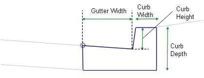

Gutter Width
Width from the flange of the gutter to the flowline
Numeric, positive
0.45 m
1.5 ft
Gutter %Slope
% slope of the gutter
Numeric
-6%
Curb Height
Height from the flowline to the top of curb
Numeric, positive
0.225 m
0.75 ft
Curb Width
Width of the top of curb
Numeric, positive
0.15 m
0.5 ft
Curb Depth
Depth from the top of curb to the bottom of curb at the back-of-curb point
Numeric, positive
0.45 m
1.5 ft

The subassembly builds the shape for a simple curb and gutter with the attachment point either at (a) the inside edge of the gutter (or lip), or (b) the back of the curb. The face of the curb is given a small, constant width to make it non-vertical.
