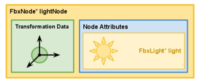

A FbxNodeAttribute is paired with a FbxNode to define a scene element with a specific position, rotation and scale. Calling FbxNode::GetNodeAttribute() will return NULL if no node attribute was set for that node.
The following code sample (adapted from ExportScene04/main.cxx to fit the diagram above) illustrates how to create a simple spotlight within a scene. Here, FbxLight* light is the node attribute of FbxNode* lightNode. For more information on lights, see Lights.
