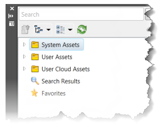

The Asset Browser provides access to System Assets, User Assets, Cloud-based Assets, and asset search results.
| Access: | Factory tab > Tools panel, click Palettes and then click Asset Browser . |
The Asset Browser is made up of the following:
| Search | Enter the name of the asset you are searching for. As you enter characters a list of matching solutions is provided. The more characters you enter, the more refined the list becomes. |
Click to begin the search using the search phrase you entered. |
There are two browser view styles - Tree and Thumbnail. Click the down arrow on the Thumbnail/Tree Views drop-down menu to select your preferred view method. |
Click to display a drop-down menu that provides options to sort assets by asset type, name, or date modified. You can choose to sort assets in either ascending (the default) or descending order. |
Refresh the browser contents. |
Indicates the number of available variations of an Asset Variant created in Inventor Factory. |

The Asset Browser provides access to all levels of the Factory Assets to allow easy navigation. Visible only when the view style is set to Thumbnail. |
