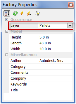

The second method involves the use of the Factory Properties browser.
- Select one or more assets from the factory floor layout. Press and hold the Ctrl or Shift keys for multiple selections.
- The layer name of the selected asset appears near the top of the Factory Properties browser. If multiple assets on different layers are selected, the layer name appears as *MultiValues*.
- Click the down arrow to the right of the layer name to display a drop-down list containing the names of all the layers defined in the current layout.
- Select the layer you wish to move the selected asset(s) to.
- The drop-down list closes and the layer you selected replaces the previous layer name.
- Click the Update button
in the Factory Properties toolbar to move the asset(s) to the different layer.
