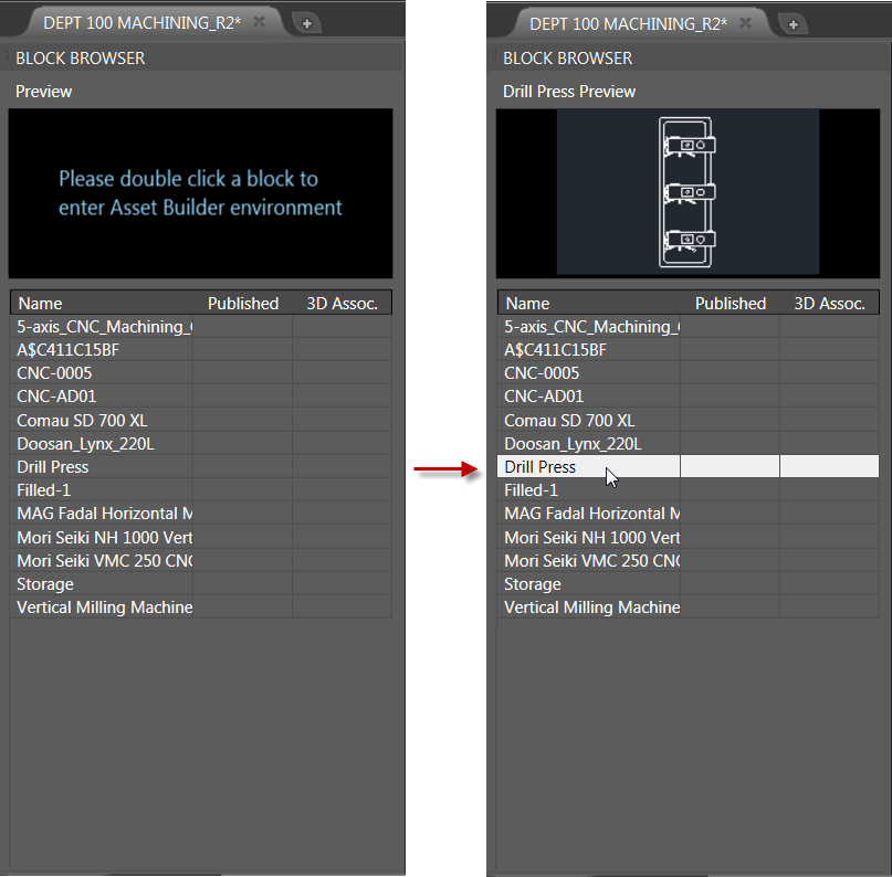

Double-click on the block you wish to convert to an asset and publish. Doing so enters the Asset Builder environment and the selected block appears in the Block Browser preview window as shown in the image above. The block is also highlighted in the graphics window.
