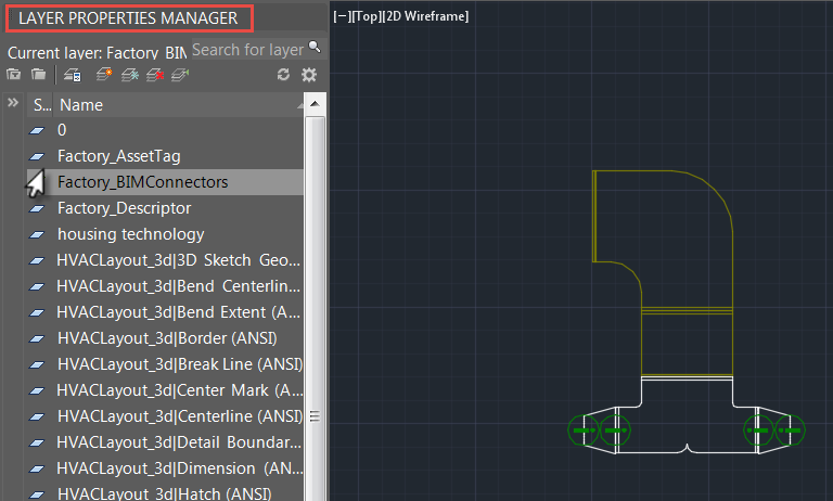

After creating factory assets with BIM (MEP) connectors in Inventor Factory, you can view information about those connectors in AutoCAD Factory.
  1. Hover over a connector to show a pop-up display of BIM connector data.
  2. You can also view factory BIM connectors in the Layer Properties Manager.
