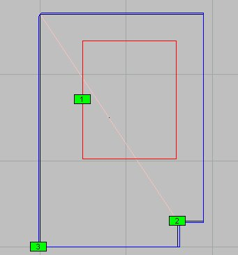

Displays the cut order for confirmation or editing. To access this screen Click on Profiler > Cut Order.
The Cut order is displayed in a Green Box. The Cursor is represented by " +1,2". As the Cursor is moved over an Island Lead In, the Cut Order Box is highlighted in Red. If you wish to re-order the Islands starting from "1";
- Click over the required Lead In position.
- The "1" will be surrounded by a white Box.
- Move to each Island in turn and click.
- Inner and Centre Line Islands should be processed before the Outer Island.
- If you make a mistake, or only need to re-order from a particular Island, Click on the Island "Cut No", that you wish the new sequence to start from, with a right-click.
- All of the Islands up to this Number will be highlighted in white. Higher numbers will be highlighted in Green.
- Click on the next Island required in the sequence.
- If using multiple Tools it is recommended that all Islands processed by the same Tool are kept together.
