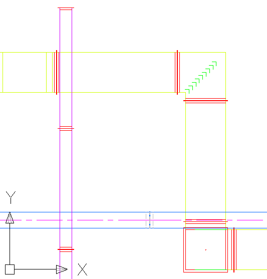

The Plan View command is designed to revert the model space drawing back to a full plan view of the complete drawing with the UCS set to world. Generally used after the CAD-Duct/CAD-Mech sectional view command.
Procedure
This sectional view command sets up 'clipping planes' and rotates the UCS to suit the new view, it may not be convenient to return to the AutoCAD® Top View as clipping planes will still be active and the complete drawing will not be visible. The CAD-Duct/CAD-Mech Plan View will return the drawing back to a overall plan view, the UCS will be return to the world status and all clipping planes will be removed.
View using CADmep Sectional View
Plan View using CADmep Plan View
