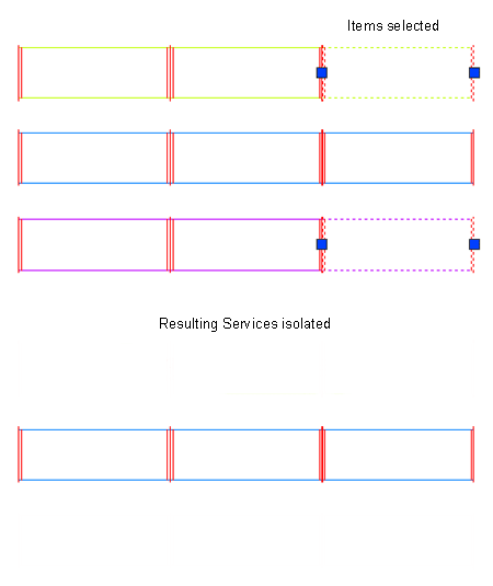

The SL1 and SL2 commands allow the user to isolate items of the same Service or Turn OFF the visibility of ALL items with the same Service as the object(s) selected.
SL1 command
Isolates the selected Items' Services by turning all other services OFF
Example:

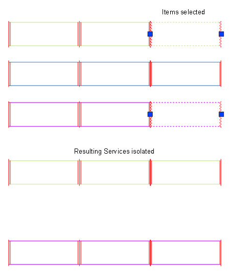

SL2 command
Turns OFF the visibility of ALL items with the same Service as the object(s) selected.
Example:
Note: Use the SHOWALL command to reinstate visibility of all objects.
