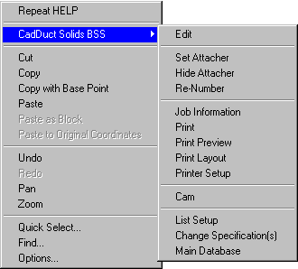

Right-click menu.
Click CadDuct Solids BSS

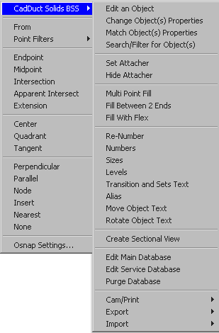

Shift right-click menu.

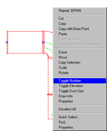

An additional menu is displayed on right-clicking when Grip Points are active:
