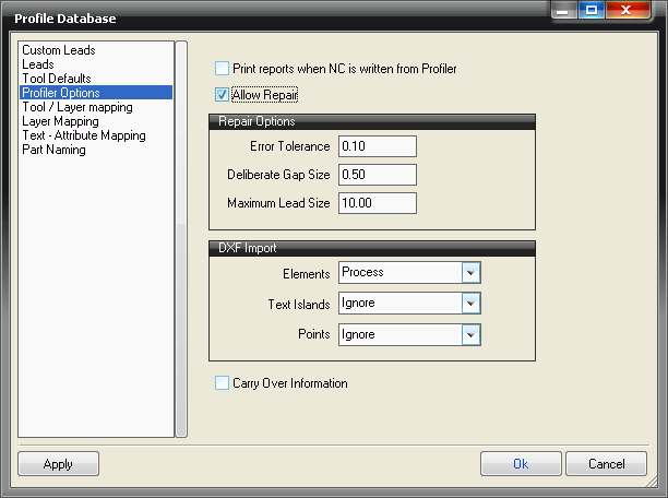

Auto Repair
Attempts to fix any problems on the part using the parameters specified in File > Setup > Profiler Database > Profiler Options.
Allow Repair When this option is ticked it allows access to the Repair Options dialogue.
Repair Options There are three options that can be adjusted in this dialogue. These are:
