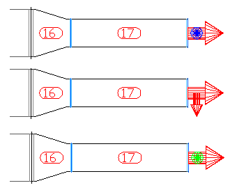

The attach arrow is colour coded. Red is plan, blue indicates the arrow direction is +Z (setting up) and green indicates -Z (setting down). (Easy way to remember - Blue for Sky, Green for Ground) After positioning and rotating the attacher arrow, the next Item added will be orientated accordingly. The attach arrow can be positioned or rotated in any view.

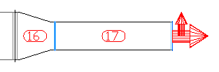

Rotating an Object about the Attacher
- Click the Attacher Icon
- Click nearest the End of the Item you wish to rotate about the Attacher.
Note: The attacher arrow must be attached to the end of the item you wish to rotate, in the example below, the end of the bend connected to the straight.
- Click the Rotate Object about Attacher button
,the command line prompts: Enter Rotation Angle: <90>.
- Enter the preferred rotation angle.
- The Item rotates about the attacher the angle specified.
