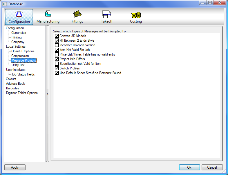

Message Prompts
This tab contains the configuration settings for several messages and warnings that can be disabled in our software. Each of these messages can be enabled and disabled by either adding or removing the tick in the checkbox beside the error message description.
Please use the Navigation & Toolbars for information on how to access the Global database using your application.
Incorrect Unicode Version
With this option selected, a message will be displayed warning the user that the database will be converted back from Unicode mode to Normal mode. This can only happen when the Unicode version of our software is run (umdiapp.exe) and then the normal version (mdiapp.exe) is run again, forcing the database to be converted back to normal mode from Unicode. Please be aware that if this happens and the user chooses "no", a default database will be created, and if any changes are made to this blank/default then the "real" database WILL be overwritten with the new one. It is not advisable to change which mode you run our software in, if in doubt please contact your agent before proceeding.
Item Not Valid for job
With this option selected the user will be informed when an item has a missing attribute, such as an item number or a material or another non critical fault which will not allow the part to be manufactured until the problem has been remedied.
Price List/Times table has no valid entry
With this message selected, messages will be displayed if entries are missing from Price list tables that are relevant to the part that the user is trying to manipulate.
Project Info Differs
With this message selected the user will be warned if the Project Info file is different to the Project, this can be caused by the job being changed on another computer, or the Project info file being saved in the wrong folder.
Specification not Valid for Item
With this option selected the user will be informed when there is an entry missing in the specification list for an item they have opened.
Switch Profiles
With this option selected the user will be informed when there is a different profile created with the current model opened, than the previous one active.
