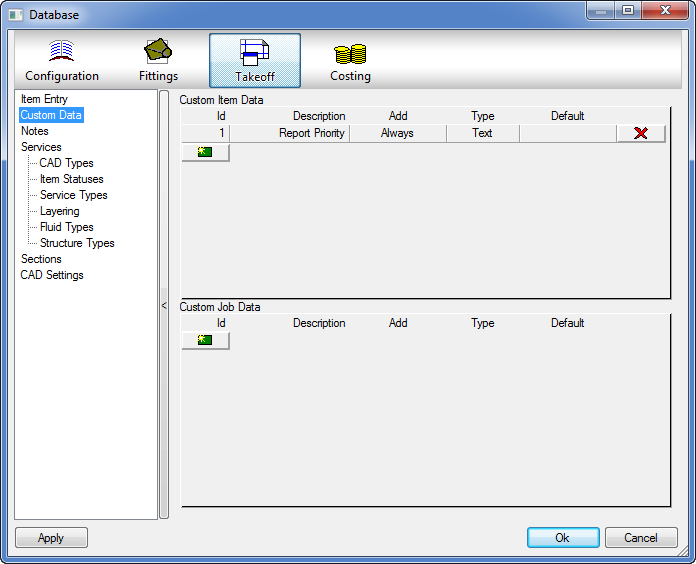

Some users may need to enter customised data during pattern input. This is made possible by using the Custom Data tab within the Main Database. This enables the user to set up bespoke information for both individual fittings and a job itself. This information can either be letters, numbers (or both) or can take the form of an indexed input.
To access Custom Data click File
Setup
Database
Takeoff
Custom Data, or select the Database icon from the Utility Bar, and the following dialogue box will appear.
This is split into two sections, Custom Item Data and Custom Job Data. These are explained below:
Custom Item Data
The Custom Item Data section allows the user to set up a field where specific information can be entered during the pattern takeoff. The user can then carry this information to reports so that the information entered can be used elsewhere at a later point. There are several things that need to be done before the Custom Item Data field can be used. These are now explained.
Setting up a Custom Item Data field
- Click on the New icon
underneath the Id field in the Custom Item Data section and the fields become active.
- The Id field allows the user to give this particular field of Custom Item Data field an Id number.
- The Description field allows the user to enter an actual name for the data field to be created. The name entered here will actually appear on the Item tab during pattern takeoff.
- The Add field offers the user two choices, these are Always and User. If Always is selected, this data field will automatically be added to the item tab for every pattern that is added by the user. If this field is set to User, this data field must be set on a fitting by fitting basis (instructions of how to do this will be detailed later). The user can set this field simply by clicking in the text field, toggling between the two options.
- The Type field offers the user several choices via a drop-down menu. This determines what type of information will actually be input during pattern takeoff. These are, None, Text, Index and Value. Although None is available it should never be selected. If Text is selected, the user can enter either letters or numbers in the field during takeoff. Index allows the user to enter a numerical figure which can also altered using up and down arrows. If Value is selected, the user can only enter a numerical value in the data field during takeoff.
- The Default field allows the user to set the default information that will automatically appear when this data field is used during pattern takeoff. This can be changed at the point of takeoff.

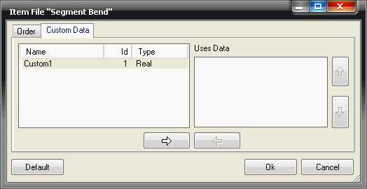

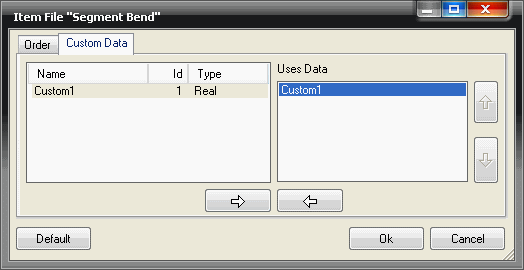

Applying a Custom Data field to a fitting If, as in the example above the Add field of the Custom Data field has been set up as User, it is then necessary for the user to then determine which fittings need to have this field attached to it.

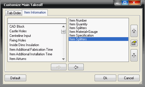

To configure all of the Item tab information for all of the fittings in one action;
- Double click on the relevant fitting icon as if it were about to be added to the job.

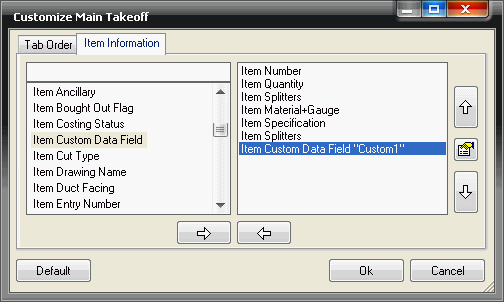

- Select the Item tab and note that the Custom Data field does not appear. Click Takeoff > Customise > Item Information and the following dialogue box will appear.
- Once again, this is split into two windows. The window on the left shows all of the information available to be viewed on the item tab. The window on the right shows all of the information currently enabled on the item tab.
- In the left hand window, locate the Item Custom Data Field and highlight it.
- Then click on the right pointing arrow to add the field to the right hand window.
- The position of the new field within the item tab is determined by its position in the right hand window. This can be changed by clicking on the Up or Down arrow on the right. In this case, to make it appear at the bottom on the item tab move it all the way down to the bottom, as in the image below.
- Then click the
icon in the middle of the up and down positioning arrows and select "Display date for index #" and the set the value to 1, the description should change to "Custom1", the name of our custom data field.

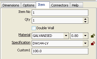

- Click Ok to confirm the changes. Take another look at the Item tab and notice that the new Custom 1 field now appears at the bottom of the list ready to use.
- These changes will also be applied to all other fittings.

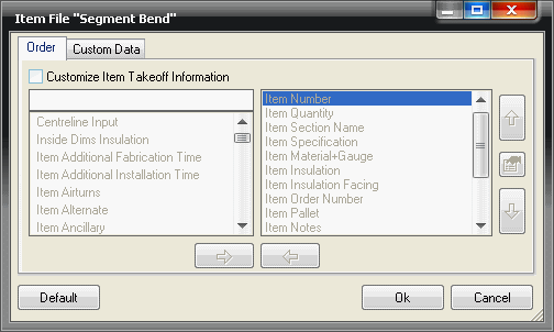

Individually
It is also possible to specifically configure the item input information for individual patterns. If this is done, it will over-ride the global settings detailed previously.
- In Item Folders, right click on the relevant icon and select Takeoff Information and the following dialogue box will appear.
- The first thing to notice is that all of the Order tab is 'greyed out'. Since this is the information that needs to be configured. It needs to be enabled.
- Click in the Customize Item Takeoff Information tick box. This then enables the whole of the Order tab to be used.
- Once this is done, the configuration of the information is done in exactly the same way as the global customisation.

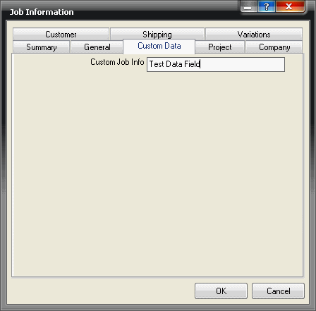

Using the Custom Job Data field
Once the Custom Job Data field has been created, it is then possible to use the field to enter relevant information to each job.
- Click File > Job Information > Custom Data and the following dialogue box will appear.
- The user is now free to enter any information they require in the field that has been set up.
