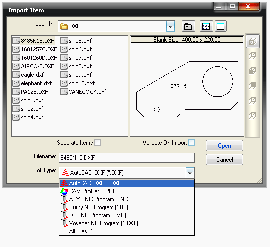

It is possible to import NC Data that has been written to a particular machine into an Item Folder or job. This will allow it to be treated in the same way as a normal part. To display the Import Item dialog.
- Click File
Import
Item.
- Select the machine type from the 'of Type' drop down to match your controller type.
- Click on the NC file to be imported.
- An image of the part or parts will appear in the preview window, clickOpen.

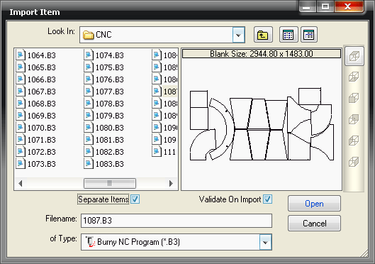

- If the NC data has more than one item in it you will have the option here to import the NC as separate items by ticking the Separate items box.
- Tick the Validate On Import box if you want Profiler to validate the part's manufacturability while importing.

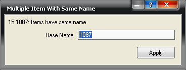

- If the separate Items box is ticked then our software will inform you that the parts all have the same name.
- You can change the base name and our software will append the name in consecutive order. i.e. MetalWork-1, MetalWork-2, MetalWork-3, etc.

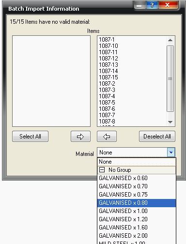

- The software will prompt you to allocate a material to the parts.
- Select a material from the pull down menu.

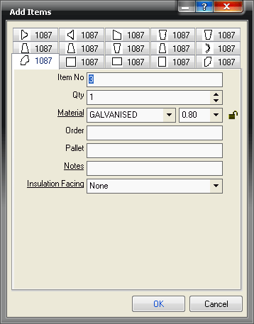

- Clicking Apply will open an " Add Item" window which will allow you to set the Item Quantity, change the material etc.
- On single items the screen will open in Opus when an Item is accepted in the Import Information box
