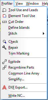

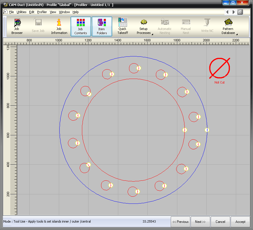

Profiler is the Module in ProfileMaster and CAMduct which pre-processes imported or CAD Drawn Parts created in Opus. To access Profiler you can Click on View > Profile from within the Opus program or click on the Profiler icon
, or type PROFILER from within the program. Profiler will open automatically when you Import a CAD item.
Once a part has been added to a job
Profiler provides options that control how the part geometry will be processed for manufacturing. Drawings cannot be altered in Profiler. To return to Opus, Click on View > Opus, to access the drawing tools or click on the Opus icon
in the toolbars or type OPUS in the program.
The commands available in Profiler are:
These can be accessed, from with the Profiler software, by selecting the Profiler Menu from the Menu bar.
