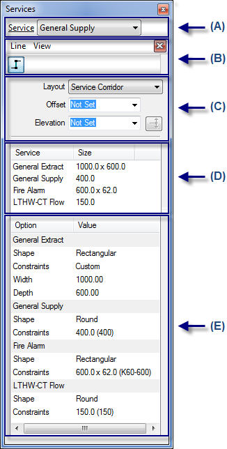

(A) : Service Menu
(B) : Multi service commands
Create
Orientation
Change
Delete
Fill
Pick Multi-Service Line
(C) : Frame, Elevation, Offset configuration dialog
Layout menu
Offset
Elevation
(D) : Service Information dialog
(E) : Service Configuration dialog
| Command | Abbreviation | Description |
| Addmslayout | AMS | Add multi-Service layout |
| Msclear | MSC | Clear Multi-Service Line Dirty-Flags |
| Msltracepath | MTP | Trace Multi-Service Line Path |
| Multiservicefill | MSF | Multi service Fill |
| Newmslobject | NMSLOBJ | Create New Multi-Service Line |
