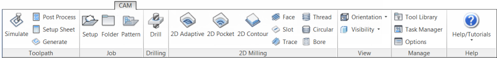

The commands offered on the Inventor HSM Express ribbon are shown below:

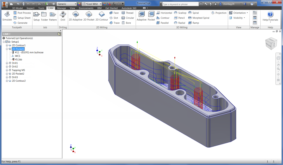

Once a part or assembly file is loaded and a strategy selected from the CAM ribbon, the CAM Browser becomes active replacing the familiar Inventor Model Browser. The CAM Browser lets you view and modify all machining-related data in the current part or assembly.
To create your first machining operation, simply select any of the toolpath strategies from the CAM toolbar. The type of toolpath required naturally depends on the geometry of your part. For a description of the individual machining strategies, please refer to the Inventor HSM Express Help topic: About 2D Machining Strategies.

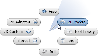

You select the first operation you wish to perform on the workpiece by clicking the appropriate icon from the command ribbon. In this example, you would click CAM tab 2D Milling panel 2D Pocket .
Remember: As an alternative, you can also right-click in an empty portion of the graphics window to display the familiar Inventor marking menu and click the appropriate marking menu node.

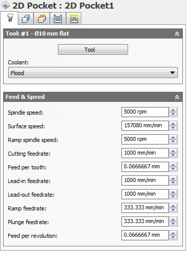

The Operation dialog box contains a number of sections with parameters controlling different aspects of the toolpath whenever you create a new machining operation. Inventor HSM Express provides working default values for all parameters, where possible. The only thing you need to do to obtain a toolpath is to select a tool and the geometry to be machined.
Tip: If you want to display both the Operation dialog box and the CAM Browser in two separate windows instead of combined, disable the Combine Operation dialog with CAM Browser setting on the User Interface tab in the CAM Options dialog box. For more information about CAM options, see the Help topic: CAM Options Reference.
Click the Tool button to open the Tool Library. Select an existing tool from a tool library by expanding the tree, selecting a tool, and clicking the OK button. Alternatively, you can create a new tool by clicking the New Mill Tool button, editing the parameters, and then clicking the Select button.
A Ø6 mm ball mill is selected from the Tool Library

Having successfully generated a toolpath, you can see a preview of the toolpath generated on top of the model simply by selecting the corresponding operation in the CAM Browser.

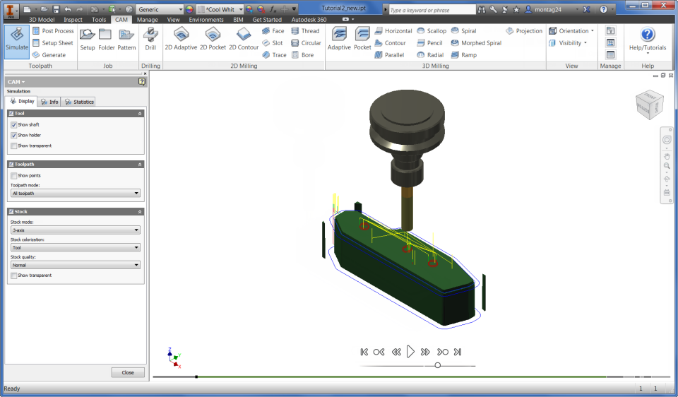

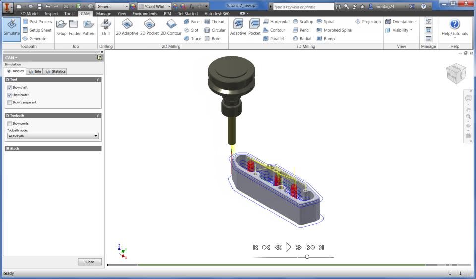

Toolpath Simulation
To simulate the toolpath, select one or more operations from the CAM Browser (multiple operations can be selected by pressing and holding the Ctrl key while clicking with the mouse), and then click CAM tab Toolpath panel Simulate on the CAM ribbon.
Stock Simulation
To invoke the solid simulation, enable the Stock check box in the Simulation dialog.

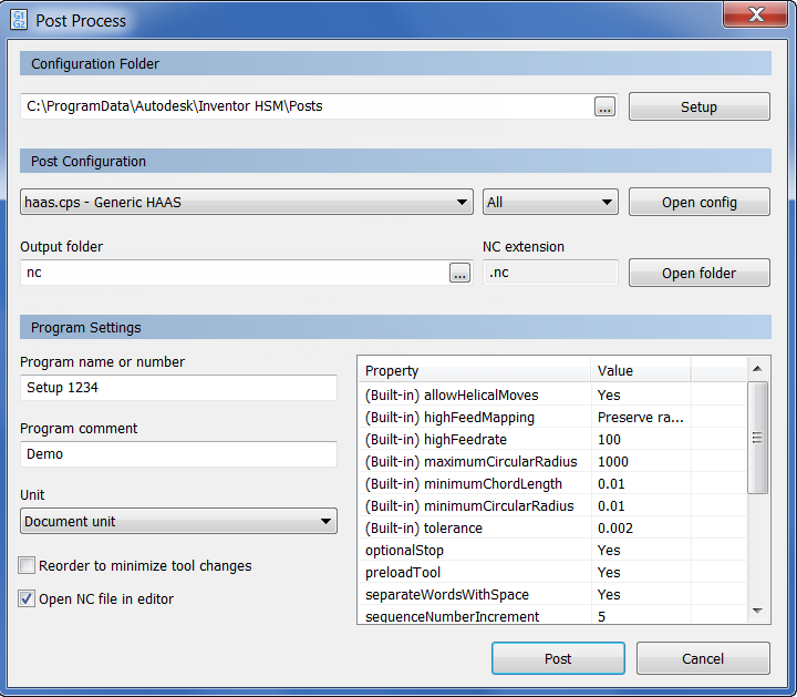

Post Processing
Inventor HSM Express ships with a number of customizable post processors that can be invoked by selecting one or more operations from the CAM Browser, and clicking CAM tab Toolpath panel Post Process on the CAM ribbon.
