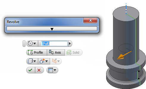

  3. Use the Revolve command to create a revolved feature from the sketch.
    A revolved feature in an Inventor part; suitable for creating a Form Mill tool
