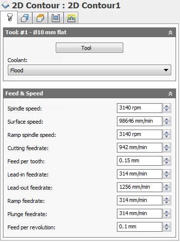

Tool tab settings
Coolant:
The type of coolant used with the tool.
Spindle speed:
The rotational speed of the spindle.
Surface speed:
The spindle speed expressed as the speed of the tool on the surface.
Ramp spindle speed:
The rotational speed of the spindle when performing ramp movements.
Cutting feedrate:
Feed used in cutting moves.
Feed per tooth:
The cutting feedrate expressed as the feed per tooth.
Lead-in feedrate:
Feed used when leading in to a cutting move.
Lead-out feedrate:
Feed used when leading out from a cutting move.
Ramp feedrate:
Feed used when doing helical ramps into stock.
Plunge feedrate:
Feed used when plunging into stock.
Feed per revolution:
The plunge feedrate expressed as the feed per revolution.

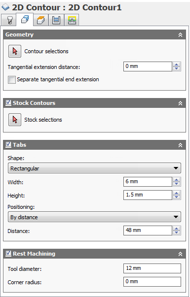

Geometry tab settings
Tangential extension distance:
Specifies the distance to extend the open contours tangentially.
No Tangential extension
10 mm Tangential extension
Separate tangential end extension
Enable to enter a tangential end extension distance value.
Tangential end extension distance:
Specifies the distance to extend the open contours tangentially at the end.
Stock Contours
Enable to specify the perimeter of the stock that needs to be faced.
Tabs
You can add tabs to the 2D Contour toolpath to hold the workpiece securely while all other material is machined away. Tabs are very useful when cutting thin plastic or wood materials using 2D routers.
Rectangular tabs
Triangular tabs
Rest Machining
Limits the operation to just remove material that a previous tool or operation could not remove.
Rest Machining ON
Rest Machining OFF
Tool diameter:
Specifies the diameter of the rest material tool.
Corner radius:
Specifies the corner radius of the rest material tool.

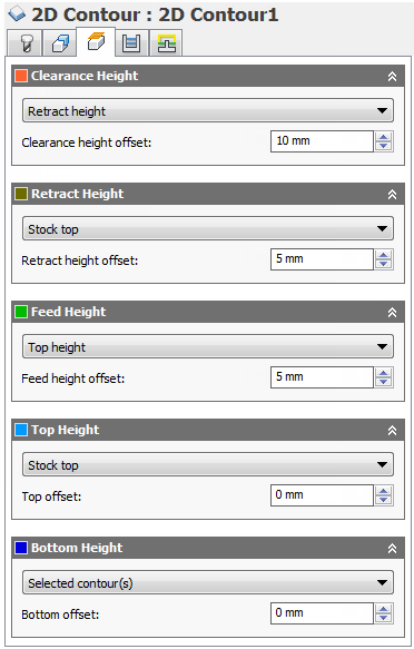

Heights tab settings
Clearance Height
The Clearance height is the first height the tool rapids to on its way to the start of the tool path.
Clearance Height
Clearance height offset:
The Clearance height offset is applied and is relative to the Clearance height mode selection in the above drop-down list.
Retract Height
Retract height mode sets the height that the tool moves up to before the next cutting pass. Retract height mode should be set above the Feed height and Top. Retract height mode is used together with the subsequent offset to establish the height.
Retract Height
Retract height offset:
Retract height offset is applied and is relative to the Retract height mode selection in the above drop-down list.
Feed Height
Feed height mode sets the height that the tool rapids to before changing to the feed/plunge rate to enter the part. Feed height mode should be set above the Top. A drilling operation uses this height as the initial feed height and the retract peck height. Feed height mode is used together with the subsequent offset to establish the height.
Feed Height
Feed height offset:
Feed height offset is applied and is relative to the Feed height mode selection in the above drop-down list.
Top Height
Top height mode sets the height that describes the top of the cut. Top height mode should be set above the Bottom. Top height mode is used together with the subsequent offset to establish the height.
Top Height
Top offset:
Top offset is applied and is relative to the Top height mode selection in the above drop-down list.
Bottom Height
Bottom height mode determines the final machining height/depth and the lowest depth that the tool descends into the stock. Bottom height mode needs to be set below the Top. Bottom height mode is used together with the subsequent offset to establish the height.
Bottom Height
Bottom offset:
Bottom offset is applied and is relative to the Bottom height mode selection in the above drop-down list.

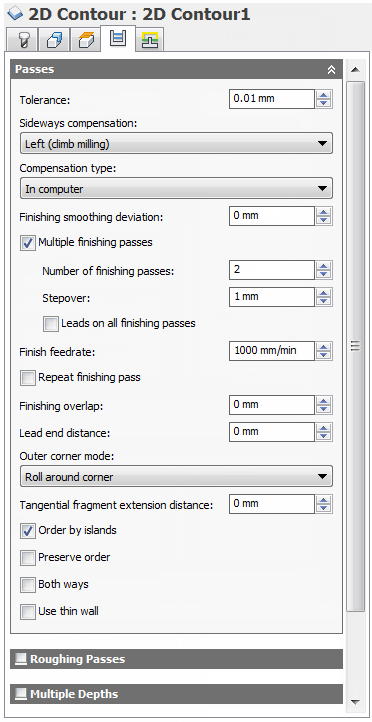

Passes tab settings
Tolerance:
The tolerance used when linearizing geometry such as splines and ellipses. The tolerance is taken as the maximum chord distance.
Loose Tolerance .100
Tight Tolerance .001
CNC machine contouring motion is controlled using line G1 and arc G2 G3 commands. To accommodate this, CAM approximates spline and surface toolpaths by linearizing them; creating many short line segments to approximate the desired shape. How accurately the toolpath matches the desired shape depends largely on the number of lines used. More lines result in a toolpath that more closely approximates the nominal shape of the spline or surface.
Data Starving
It is tempting to always use very tight tolerances, but there are trade-offs including longer toolpath calculation times, large G-code files, and very short line moves. The first two are not much of a problem because Inventor HSM Express calculates very quickly and most modern controls have at least 1MB of RAM. However, short line moves, coupled with high feedrates, may result in a phenomenon known as data starving.
Data starving occurs when the control becomes so overwhelmed with data that it cannot keep up. CNC controls can only process a finite number of lines of code (blocks) per second. That can be as few as 40 blocks/second on older machines and 1,000 blocks/second or more on a newer machine like the Haas Automation control. Short line moves and high feedrates can force the processing rate beyond what the control can handle. When that happens, the machine must pause after each move and wait for the next servo command from the control.
Sideways compensation:
Specifies the compensation direction.
Compensation type:
Specifies the compensation type.
Note: Control compensation (including Wear and Inverse wear) is only done on finishing passes.
Compensation radius allowance:
This parameter specifies a range of tool diameters that can be safely used, instead of only the tool selected for the operation.
The allowed range of tool radii start from the selected tool radius and goes up to the selected tool radius, plus the given allowance.
Make sharp corners
Specifies that sharp corners must be forced.
Caution: Using a smaller tool on the machine can cause a gouge when using this feature.
Finishing smoothing deviation:
The maximum amount of smoothing applied to the finishing passes. Use this parameter to avoid sharp corners in the toolpath. Setting this parameter leaves more stock than requested at the contour corners.
Multiple finishing passes
Enable to perform multiple finishing passes.
Number of finishing passes:
Specifies the number of finishing passes.
Shown with three finishing passes
Stepover:
The maximum distance between finishing passes.
Leads on all finishing passes
Forces a full lead in and out on every finishing pass.
Enabled
Disabled
Note: Lead parameters are set on the Linking tab.
Finish feedrate:
Feedrate used for the final finishing pass.
Repeat finishing pass
Enable to perform the final finishing pass twice to remove stock left due to tool deflection.
Finishing overlap:
The finishing overlap is the distance that the tool passes beyond the entry point before leading out. Specifying a finishing overlap ensures that the material at the entry point is properly cleared.
No finishing overlap
0.25" finishing overlap
Note: The finishing overlap follows the selected contour, so it is safe to specify a large overlap.
Lead end distance:
Specifies the distance the lead-out feed rate begins before the end of the selected geometry.
@ 0"
@ .5"
Note: This option is used when you desire to change the feedrate prior to breaking through at the end of the cut.
Outer corner mode
When machining outer corners, it may be necessary to avoid rolling around the corner in order to leave the corner perfectly sharp.
The Outer corner mode setting lets you machine outer corners in three different ways.
Order by islands
Specifies in which order the depth cuts are taken when there are multiple profiles.
Disabled
Disabled - Depth cuts are ordered by depth.
Enabled
Enabled - Depth cuts are ordered by profile.
Note: Ordering cuts by island minimizes the number of rapid moves.
Preserve order
Specifies that features are machined in the order in which they were selected. When unselected, Inventor HSM Express optimizes the cut order.
Both ways
Specifies that the operation will use both Climb and Conventional milling to machine open profiles.
Unselected
Selected
Note: This option only controls how multiple depth cuts are taken on a single open contour. It does not optimize the cut direction for multiple open contours.
Use thin wall
When milling part features with wall thicknesses comparable to sheet metal stock, or even thinner, the stock is subjected to the forces generated by metal removal. This can result in the delicate structure of thin walls moving relative to the tool, making it difficult to maintain dimensional accuracy and impart the specified surface finish.
This option can be used to reduce the vibration and chatter by ensuring that both sides of a thin wall are machined at the same time.
Thin wall width:
The width of walls that should be considered thin walls.
Any wall with this width (or thinner) is machined on both sides at the same time to reduce vibration and chatter.

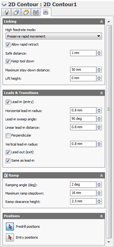

Linking tab settings
High feedrate mode:
Specifies when rapid movements should be output as true rapids (G0) and when they should be output as high feedrate movements (G1).
This parameter is usually set to avoid collisions at rapids on machines which perform "dog-leg" movements at rapid.
High feedrate:
The feedrate to use for rapid movements output as G1 instead of G0.
Allow rapid retract
When enabled, retracts are done as rapid movements (G0). Disable to force retracts at lead-out feedrate.
Safe distance:
Minimum distance between the tool and the part surfaces during retract moves. The distance is measured after stock to leave has been applied, so if a negative stock to leave is used, special care should be taken to ensure that safe distance is large enough to prevent any collisions.
Keep tool down
When enabled, the strategy avoids retracting when the distance to the next area is below the specified stay-down distance.
Maximum stay-down distance:
Specifies the maximum distance allowed for stay-down moves.
1" Maximum stay-down
2" Maximum stay-down distance
Lift height:
Specifies the lift distance during repositioning moves.
Lift height 0
Lift height .1 in
Lead-in (entry)
Enable to generate a lead-in.
Lead-in
Horizontal lead-in radius:
Specifies the radius for horizontal lead-in moves.
Lead-in sweep angle:
Specifies the sweep of the lead-in arc.
Sweep angle @ 90 degrees
Sweep angle @ 45 degrees
Linear lead-in distance:
Specifies the length of the linear lead-in move for which to activate radius compensation in the controller.
Perpendicular
Replaces tangential extensions of lead-in/lead-out arcs with a move perpendicular to the arc.
Shown with Perpendicular entry/exit
Example: A bore with lead arcs that are as large as possible (the larger the arc the less chance of dwell mark), and where a tangent linear lead is not possible because it would extend into the side of the bore.
Vertical lead-in radius:
The radius of the vertical arc smoothing the entry move as it goes from the entry move to the toolpath itself.
Lead-out (exit)
Enable to generate a lead-out.
Lead-out
Same as lead-in
Specifies that the lead-out definition should be identical to the lead-in definition.
Linear lead-out distance:
Specifies the length of the linear lead-out move for which to deactivate radius compensation in the controller.
Horizontal lead-out radius:
Specifies the radius for horizontal lead-out moves.
Vertical lead-out radius:
Specifies the radius of the vertical lead-out.
Lead-out sweep angle:
Specifies the sweep of the lead-out arc.
Perpendicular
Example: A bore with lead arcs that are as large as possible (the larger the arc the less chance of dwell mark),and where a tangent linear lead is not possible because it would extend into the side of the bore.
Ramp
Enable ramps.
Shown with a 15 degree Ramping angle
Ramping angle (deg):
Specifies the maximum ramping angle.
Maximum ramp stepdown:
Specifies the maximum stepdown per revolution on the ramping profile. This parameter allows the tool load to be constrained when doing full-width cuts during ramping.
Ramp clearance height:
Height of ramp over the current stock level.
Helical ramp diameter:
Specifies the helical ramp diameter.
Minimum ramp diameter:
Specifies the minimum ramp diameter.
Predrill positions
Selection button to choose predrill positions.
Entry positions
Selection button to choose entry positions.
