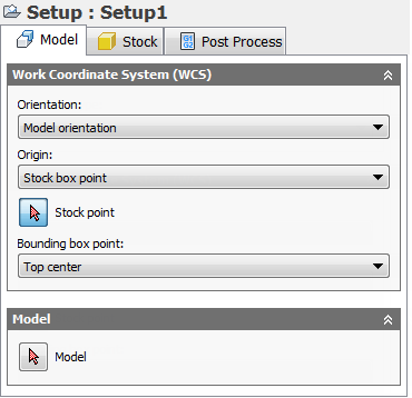

Setup
to display the Setup dialog box.
The Setup operations dialog box appears with the Model tab active

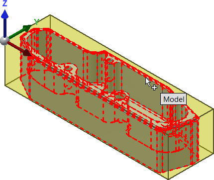

In the graphics window, the stock material is created automatically around the bounding box of the part. The model orientation is shown by the WCS at the top center of the part. The XYZ orientation is correct, but we need to change the WCS origin.
The Top corner 1 bounding box point
The WCS is now re-oriented at the lower left of the top face of the stock
As with the stock, defining the machining surfaces is not strictly necessary. But we do it here as an exercise for more complicated setups.
Selecting the model within the bounding box
