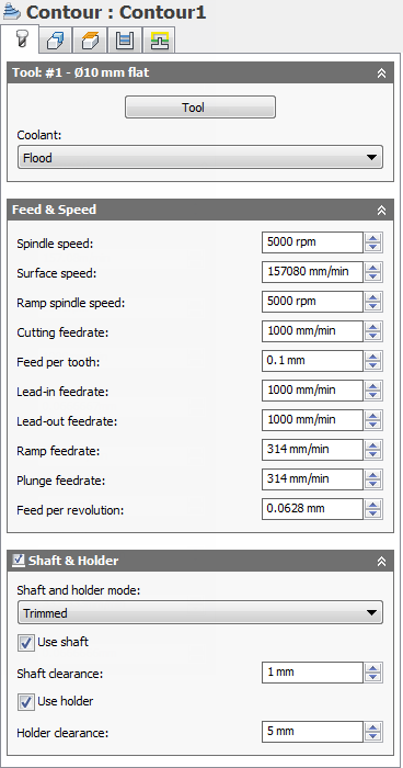

The type of coolant used with the tool.
The rotational speed of the spindle.
The spindle speed expressed as the speed of the tool on the surface.
The rotational speed of the spindle when performing ramp movements.
Feed used in cutting moves.
The cutting feedrate expressed as the feed per tooth.
Feed used when leading in to a cutting move.
Feed used when leading out from a cutting move.
Feed used when doing helical ramps into stock.
Feed used when plunging into stock.
The plunge feedrate expressed as the feed per revolution.
When using a tool with a holder, you can choose between one of five different shaft and holder modes, depending on the machining strategy. Collision handling can be done for both the tool shaft and holder, and they can be given separate clearances.
Disabled
Pull away
Trimmed
Detect tool length
Specifies that the shaft of the selected tool will be used in the toolpath calculation to avoid collisions.
The tool shaft always stays this distance from the part.
Specifies that the holder of the selected tool will be used in the toolpath calculation to avoid collisions.
The tool holder always stays this distance from the part.

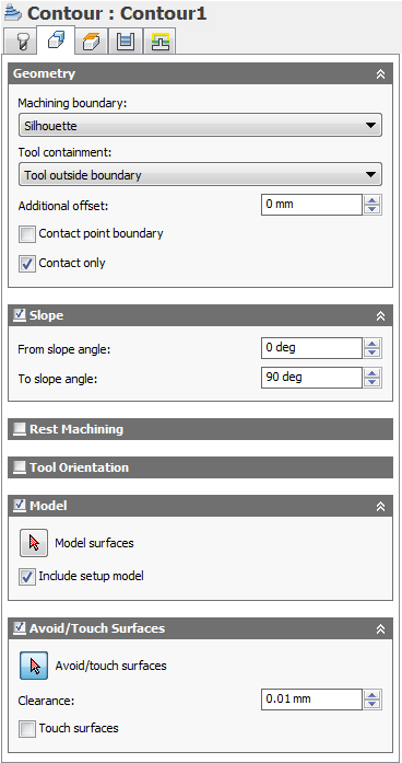

Boundaries mode specifies how the toolpath boundary is defined. The following images are shown using a 3D Radial toolpath.
Example 1
Example 2
Boundary modes:
Bounding box
Silhouette
Selection
Use tool containment to control the tools' position in relation to the selected boundary or boundaries.
Inside
The entire tool stays inside the boundary. As a result, the entire surface contained by the boundary might not be machined.
Inside
Center
The boundary limits the center of the tool. This setting ensures that the entire surface inside the boundary is machined. However, areas outside the boundary or boundaries might also be machined.
Center
Outside
The toolpath is created inside the boundary, but the tool edge can move on the outside edge of the boundary.
Outside
To offset the boundary containment, use the Additional offset parameter.
The additional offset is applied to the selected boundary/boundaries and tool containment.
A positive value offsets the boundary outwards unless the tool containment is Inside, in which case a positive value offsets inwards.
Negative offset with tool center on boundary
No offset with tool center on boundary
Positive offset with tool center on boundary
To ensure that the edge of the tool overlaps the boundary, select the Outside tool containment method and specify a small positive value.
To ensure that the edge of the tool is completely clear of the boundary, select the Inside tool containment method and specify a small positive value.
When enabled, specifies that the boundary limits where the tool touches the part rather than the tool center location.
Disabled
Enabled
The difference is illustrated below on a Parallel toolpath using a ball end mill.
Disabled
Enabled
Controls whether or not toolpaths are generated where the tool is not in contact with the machining surface. When disabled, toolpaths are extended to the limits of the containment boundary and across openings in the workpiece.
Enabled
Disabled
Contains toolpaths based on a range of specified angles.
0° - 90°
0° - 45°
45° - 90°
Slope angle confinement is specified by the From slope angle and To slope angle angle parameters on the Geometry tab. Angles are defined from 0° (horizontal) to 90° (vertical).
Only areas equal to or greater than the values in the From slope angle and To slope angle parameters are machined.
Most 3D finishing strategies support slope angle confinement. One use of slope confinement is to confine a selected toolpath strategy to angles where it works best. For example, Parallel Finish is better suited to shallow areas while Contour Finish is better suited to steep areas.
From slope angle is defined from the 0° (horizontal) plane. Only areas equal to or greater than this value are machined.
Slope angle from 0°
To slope angle is defined from the 0° (horizontal) plane. Only areas equal to or less than this value are machined.
Slope angle to 90°
Limits the operation to just remove material that a previous tool or operation could not remove.
Rest Machining ON
Rest Machining OFF
Specifies the source from which the rest machining is to be calculated.
Union of all dependent operations.
Include all previous operations.
Specifies the diameter of the rest material tool.
Specifies the corner radius of the rest material tool.
Specifies the rest material tool taper angle.
Specifies the rest material tool shoulder length.
Specifies the rest material file.
Selects the rest material adjustment for respectively ignoring or ensuring milling of small cusps.
This parameter specifies the amount of stock to be ignored, or additionally removed, depending on the Rest Material Adjustment setting. The parameter is primarily used to avoid machining of minor rest material with the Ignore cusps setting.
Specifies how the tool orientation is determined using a combination of triad orientation and origin options.
The Orientation drop-down menu provides the following options to set the orientation of the X, Y, and Z triad axes:
The Origin drop-down menu offers the following options for locating the triad origin:
Enable to override the model geometry (surfaces/bodies) defined in the setup.
Enabled by default, the model selected in the setup is included in addition to the model surfaces selected in the operation. If you disable this check box, then the toolpath is generated only on the surfaces selected in the operation.
Specifies surfaces to avoid. When enabled, toolpaths stay away from the selected surfaces by a specified amount.
Disabled
Enabled
The tool always stays this distance from the selected surfaces.
Inverts the meaning of the Avoid surfaces setting. When enabled, the avoid surfaces are the ones that must be touched within the given clearance while the remaining surfaces are avoided.
Touch surfaces

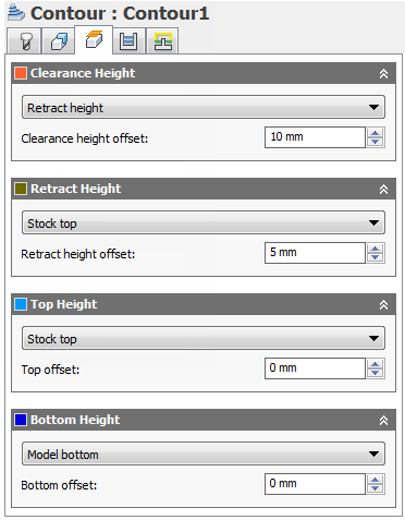

The Clearance height is the first height the tool rapids to on its way to the start of the tool path.
Clearance Height
The Clearance height offset is applied and is relative to the Clearance height mode selection in the above drop-down list.
Retract height mode sets the height that the tool moves up to before the next cutting pass. Retract height mode should be set above the Feed height and Top. Retract height mode is used together with the subsequent offset to establish the height.
Retract Height
Retract height offset is applied and is relative to the Retract height mode selection in the above drop-down list.
Top height mode sets the height that describes the top of the cut. Top height mode should be set above the Bottom. Top height mode is used together with the subsequent offset to establish the height.
Top Height
Top offset is applied and is relative to the Top height mode selection in the above drop-down list.
Bottom height mode determines the final machining height/depth and the lowest depth that the tool descends into the stock. Bottom height mode needs to be set below the Top. Bottom height mode is used together with the subsequent offset to establish the height.
Bottom Height
Bottom offset is applied and is relative to the Bottom height mode selection in the above drop-down list.

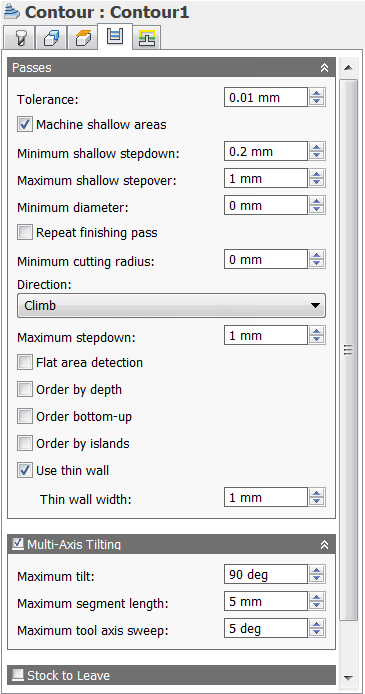

The machining tolerance is the sum of the tolerances used for toolpath generation and geometry triangulation. Any additional filtering tolerances must be added to this tolerance to get the total tolerance.
Loose Tolerance .100
Tight Tolerance .001
CNC machine contouring motion is controlled using line G1 and arc G2 G3 commands. To accommodate this, CAM approximates spline and surface toolpaths by linearizing them creating many short line segments to approximate the desired shape. How accurately the toolpath matches the desired shape depends largely on the number of lines used. More lines result in a toolpath that more closely approximates the nominal shape of the spline or surface.
Data Starving
It is tempting to always use very tight tolerances, but there are trade-offs including longer toolpath calculation times, large G-code files, and very short line moves. The first two are not much of a problem because Inventor HSM Pro calculates very quickly and most modern controls have at least 1MB of RAM. However, short line moves, coupled with high feedrates, may result in a phenomenon known as data starving.
Data starving occurs when the control becomes so overwhelmed with data that it cannot keep up. CNC controls can only process a finite number of lines of code (blocks) per second. That can be as few as 40 blocks/second on older machines and 1,000 blocks/second or more on a newer machine like the Haas Automation control. Short line moves and high feedrates can force the processing rate beyond what the control can handle. When that happens, the machine must pause after each move and wait for the next servo command from the control.
Specifies that additional Z-levels should be cuts at shallow areas. The following two images are shown with 3D Contour.
Disabled
Enabled
This parameter controls the minimum allowed stepdown between the extra Z-levels. It takes precedence over the Maximum shallow stepover value.
This parameter controls the stepover used to detect areas where extra Z-levels should be inserted. If the normal stepdown results in a stepover of more than this value, extra levels are inserted until the stepover or the minimum stepdown is reached.
The diameter of the smallest holes to machine.
Enable to perform the final finishing pass twice to remove stock left due to tool deflection.
With Minimum cutting radius set
With Minimum cutting radius set - sharp corners in the toolpath are avoided minimizing chatter in finished parts.
Without Minimum cutting radius set
Without Minimum cutting radius set - the toolpath attempts to remove material anywhere the selected tool can reach. This produces sharp corners in the toolpath that often leads to chatter in the machined part.
The Direction option lets you control if Inventor HSM Pro should try to maintain either Climb or Conventional milling.
Climb
Select Climb to machine all the passes in a single direction. When this method is used, Inventor HSM Pro attempts to use climb milling relative to the selected boundaries.
Climb
Conventional
This reverses the direction of the toolpath compared to the Climb setting to generate a conventional milling toolpath.
Conventional
Specifies the maximum stepdown between Z-levels.
If enabled, the strategy attempts to detect the heights of flat areas and peaks, and machine at these levels.
If disabled, the strategy machines at exactly the specified stepdowns.
Specifies that the passes should be ordered top down.
Disabled
Enabled
Contour passes are usually ordered from top to bottom. Enable this check box to specify that passes should be ordered bottom-up (bottom to top).
Ordering is done so that the passes with the smallest Z-level tool orientation are done first in one operation for multiple contours. This method is very useful for machining fragile materials like graphite.
Specifies the order in which depth cuts are taken when there are multiple profiles.
Disabled
Disabled - Depth cuts are ordered by depth.
Enabled
Enabled - Depth cuts are ordered by profile.
When milling part features with wall thicknesses comparable to sheet metal stock, or even thinner, the stock is subjected to the forces generated by metal removal. This can result in the delicate structure of thin walls moving relative to the tool, making it difficult to maintain dimensional accuracy and impart the specified surface finish.
This option can be used to reduce the vibration and chatter by ensuring that both sides of a thin wall are machined at the same time.
The width of walls that should be considered thin walls.
Any wall with this width or thinner is machined on both sides at the same time to reduce vibration and chatter.
Enables multi-axis tilt to avoid collision with the holder when using short tools.
Specifies the maximum allowed tilt from the selected operation tool axis.
Specifies the maximum length of a single segment for the generated toolpath.
Specifies the maximum angle change in a single tool axis sweep for the generated toolpath.
Positive
Positive Stock to Leave - The amount of stock left after an operation to be removed by subsequent roughing or finishing operations. For roughing operations, the default is to leave a small amount of material.
None
No Stock to Leave - Remove all excess material up to the selected geometry.
Negative
Negative Stock to Leave - Removes material beyond the part surface or boundary. This technique is often used in Electrode Machining to allow for a spark gap, or to meet tolerance requirements of a part.
The Radial stock to leave parameter controls the amount of material to leave in the radial (perpendicular to the tool axis) direction, i.e. at the side of the tool.
Radial and axial stock to leave
Specifying a positive radial stock to leave results in material being left on the vertical walls and steep areas of the part.
For surfaces that are not exactly vertical, Inventor HSM Pro interpolates between the axial (floor) and radial stock to leave values, so the stock left in the radial direction on these surfaces might be different from the specified value, depending on surface slope and the axial stock to leave value.
Changing the radial stock to leave automatically sets the axial stock to leave to the same amount, unless you manually enter the axial stock to leave.
For finishing operations, the default value is 0 mm / 0 in, i.e. no material is left.
For roughing operations, the default is to leave a small amount of material that can then be removed later by one or more finishing operations.
Negative stock to leave
When using a negative stock to leave, the machining operation removes more material from your stock than your model shape. This can be used to machine electrodes with a spark gap, where the size of the spark gap is equal to the negative stock to leave.
Both the radial and axial stock to leave can be negative numbers. However, the negative radial stock to leave must be less than the tool radius.
When using a ball or radius cutter with a negative radial stock to leave that is greater than the corner radius, the negative axial stock to leave must be less than or equal to the corner radius.
The Axial stock to leave parameter controls the amount of material to leave in the axial (along the Z-axis) direction, i.e. at the end of the tool.
Both radial and axial stock to leave
Specifying a positive axial stock to leave results in material being left on the shallow areas of the part.
For surfaces that are not exactly horizontal, Inventor HSM Pro interpolates between the axial and radial (wall) stock to leave values, so the stock left in the axial direction on these surfaces might be different from the specified value depending on surface slope and the radial stock to leave value.
When using a negative stock to leave the machining operation removes more material from your stock than your model shape. This can be used to machine electrodes with a spark gap, where the size of the spark gap is equal to the negative stock to leave.
Both the radial and axial stock to leave can be negative numbers. However, when using a ball or radius cutter with a negative radial stock to leave that is greater than the corner radius, the negative axial stock to leave must be less than or equal to the corner radius.
Enable to enter a fillet radius.
Specify a fillet radius.
Smooths the toolpath by removing excessive points and fitting arcs where possible within the given filtering tolerance.
Smoothing Off
Smoothing On
Smoothing is used to reduce code size without sacrificing accuracy. Smoothing works by replacing collinear lines with one line and tangent arcs to replace multiple lines in curved areas.
The effects of smoothing can be dramatic. G-code file size may be reduced by as much as 50% or more. The machine will run faster and more smoothly and surface finish improves. The amount of code reduction depends on how well the toolpath lends itself to smoothing. Toolpaths that lay primarily in a major plane (XY, XZ, YZ), like parallel paths, filter well. Those that do not, such as 3D Scallop, are reduced less.
Specifies the smoothing filter tolerance.
Smoothing works best when the Tolerance (the accuracy with which the original linearized path is generated) is equal to or greater than the Smoothing (line arc fitting) tolerance.
Specifies that the feed should be reduced at corners.
Specifies the maximum angular change allowed before the feedrate is reduced.
Specifies the minimum radius allowed before the feed is reduced.
Specifies the distance to reduce the feed before a corner.
Specifies the reduced feedrate to be used at corners.
Only reduce the feedrate on inner corners.

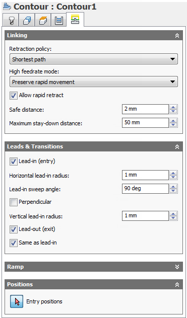

Controls how the tool moves between cutting passes. The following images are shown using the Flow strategy.
For CNC machines that do not support linearized rapid moves, the post processor can be modified to convert all G0 moves to high-feed G1 moves. Contact technical support for more information or instructions how to modify post processors as described.
Specifies when rapid movements should be output as true rapids (G0) and when they should be output as high feedrate movements (G1).
This parameter is usually set to avoid collisions at rapids on machines which perform "dog-leg" movements at rapid.
The feedrate to use for rapids movements output as G1 instead of G0.
When enabled, retracts are done as rapid movements (G0). Disable to force retracts at lead-out feedrate.
Minimum distance between the tool and the part surfaces during retract moves. The distance is measured after stock to leave has been applied, so if a negative stock to leave is used, special care should be taken to ensure that safe distance is large enough to prevent any collisions.
Specifies the maximum distance allowed for stay-down moves.
1" Maximum stay-down distance
2" Maximum stay-down distance
Enable to generate a lead-in.
Lead-in
Specifies the radius for horizontal lead-in moves.
Horizontal lead-in radius
Specifies the sweep of the lead-in arc.
Sweep angle @ 90 degrees
Sweep angle @ 45 degrees
Replaces tangential extensions of lead-in/lead-out arcs with a move perpendicular to the arc.
Shown with Perpendicular entry/exit
Example: A bore that has lead arcs that are as large as possible (the larger the arc the less chance of dwell mark), and where a tangent linear lead is not possible because it would extend into the side of the bore.
The radius of the vertical arc smoothing the entry move as it goes from the entry move to the toolpath itself.
Vertical lead-in radius
Enable to generate a lead-out.
Lead-out
Specifies that the lead-out definition should be identical to the lead-in definition.
Specifies the radius for horizontal lead-out moves.
Horizontal lead-out radius
Specifies the radius of the vertical lead-out.
Vertical lead-out radius
Specifies the sweep of the lead-out arc.
Specifies how the cutter moves down for each depth cut.
Predrill
Plunge
Zig-Zag
Notice the smooth transitions on the Zig-Zag ramp type.
Profile
Smooth Profile
Helix
Specifies the type of connection done between passes.
Specifies the maximum ramping angle.
Specifies the maximum stepdown per revolution on the ramping profile. This parameter allows the tool load to be constrained when doing full-width cuts during ramping.
Height of ramp over the current stock level.
Specifies the helical ramp diameter.
When enabled, ramps are started and ended tangentially in all three axes.
Ramping is done without discontinuities in the first order derivative so that smooth curves are used instead of the usual kinks in the path.
Selection button to choose entry positions.
