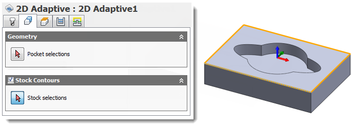

  1. On the Geometry tab, activate the Stock Contours check box, click the Stock selections button and select the stock contour for the facing operation.
    Selecting the stock contour
The resulting toolpath should look similar to that shown below:
